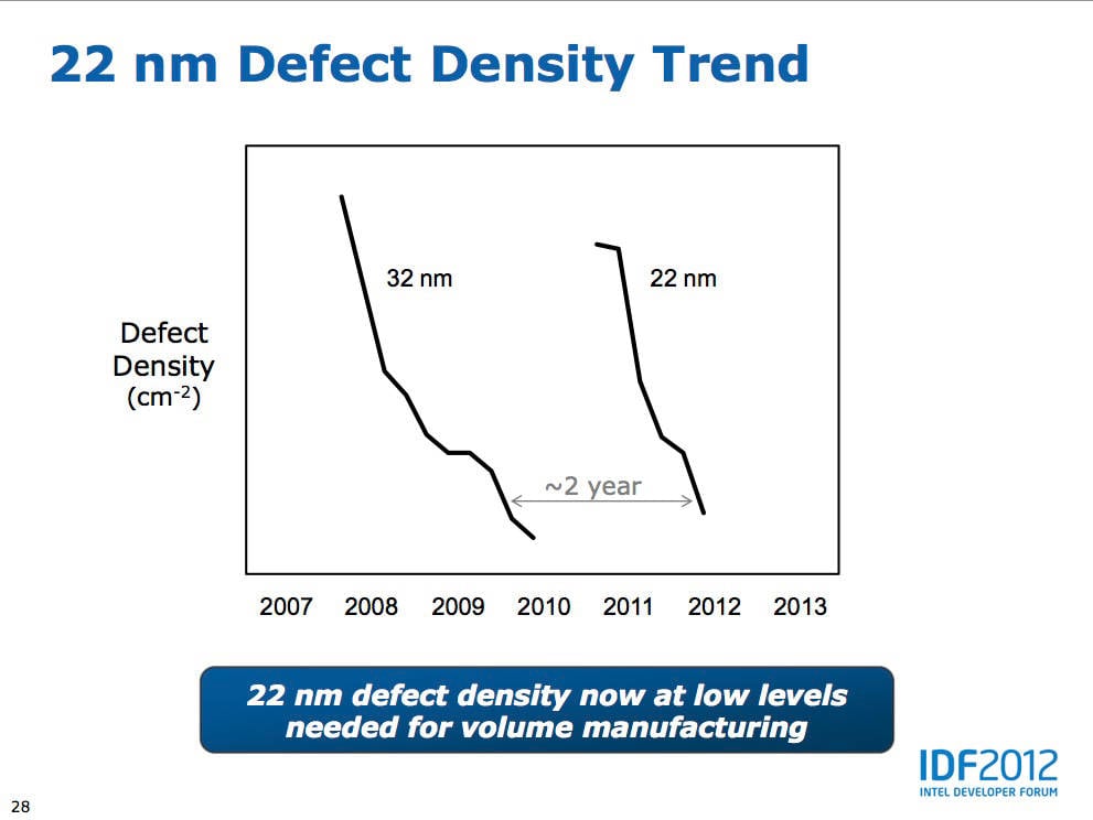

I wonder how Intel's 10nm yiels is doing and will be doing. Are they already nearing the lower side of the curve and will they take the next 1.5 years to get just that little bit higher:
BTW, the orange line on the first image goes to Feb 2014: http://intelstudios.edgesuite.net/im/2014/pdf/2014_Intel_IM_Holt.pdf. You can really see that the last data point on Mark Bohr's yield curve was basically the last time they saw improvement at that decent pace which would put them on par in Q2 or even in Q1'15, but in Q4 it flattened and it didn't ever become better. So that's why, although they had already started the front-end of the 10nm start-up for early '16 production in Q4'14, they decided in Q1 to abort the start-up, so really at the last minute. If the 14nm curve would have continued at Bohr's projected pace (which seemed like a reasonable estimate at the time), 10nm, Gen10 and Cannonlake would have been here with us up to a year earlier. Really mind blowing if you think about how close the delay was to manufacturing, just like with 14nm in fact. Gotta love how close they were to matching 22nm in Q3'14.
Anyway, or will they ramp their yields much later and much quicker like 22nm?
Give they will have to use triple or quadruple patterning, I guess the first...
Some more yield curves:
