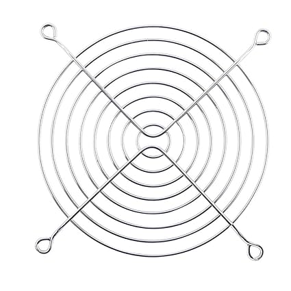

Since 2101 I have been removing the rear grill and the exhaust fan on steel cases or removing the exhaust fan on Lian Li cases see here)(https://www.overclock.net/forum/246-air-cooling/1594120-negative-pressure-rig-no-case-fans.html). I also remove PCIe slot covers. So far, I have left the IO shields in place.
A lot of people don't realize how restrictive those rear exhaust grills are (and the turbulence of the air hitting it adds noise as well). I really wish more case manufacturers went back to this style instead of using the honeycomb style ones:
I did a mod on a case some years ago as i came to that conclusion as well and i used that exact kind of grill. :) It certainly did improve rear airflow. I lack a dremel tool to do that now. I even did that on the side panel of this case as well.
You don't need a Dremel. A pair of side-cutters will do. When you have cut off the "grill" you can tape the cut edges with Gorilla tape. The "finger protector" can be held on with fan screws which screw into #10 plastic nuts. You can get plastic nuts at an auto supply store. People use plastic nuts for license plates.
Yup i did it with side cutters last time but the job kind of looked half assed lol. I guess i shouldn't have cared given i did it to a Hp oem tower so i could run a 770 in it without issues. Put the 80mm rear one on and a side 120mm fan where ventilation was at. Had no issues keeping that card cool. For a moment before the 120mm i strapped a desktop fan where the 120mm ended up and honestly that cooled it down just as well. Was about as ghetto as water in place of milk when you cook kraft mac n cheese.
I guess as long as its just the rear i don't care how it will look. :) May do that again in the future. Just this meshify c mini looks so pretty compared to the usual trash i put my tower into.
It may look half-@$$ed now. Across the years I went from filing those edges (empty case until cleanup was finished) to cut pieces of report covers to Gorilla tape. Try the tape. I make everything look neat + you cab lift it without cutting yourself.

My case is a wind tunnel. It's a Rosewill Thor v2 with all the stock case fans @ 100%. Best setup I've had to date, I think.
One thing I discovered in 2010: you do not need case fans to produce a wind tunnel. This seems to replicate your own experience.
Since 2010 I have removed all "grills" from steel cases (usually just perforated steel walls; aluminum cases usually have no rear "grills") and lived without the additional fan and noise. I recommend it.
