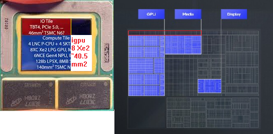

How can it be 400mm2 for 32xe2 cores. What about the shiping manifests 56/64xe2 versions that would put them above reticle limit.
8 cores of Xe2_lpg die area is ~40.7mm2 Media is ~13.5mm2 display ~7mm2 Assuming 1 display engine and 1 media engine 20Xe2 core should be: 122,25mm2 on N3E ? and around 153,625mm2 on N4 [N5->N3E is 1.3x chip density N5-N4 is 1.06x]
Im missing L2$ controls, 2 gddr phys or 1 gddr phys (192/256bit) and l2$
Still 270mm2 for 20xe2 cores and 400mm2 for 32xe2 seems ridiculous too me.
After some calculations i would put this at
32Xe2: 205-275mm2
64Xe2: 410-550mm2
If 32xe2 is 400mm2 and 4070non-super competitor bmg is DOA... 4070ti is 294.5mm2
