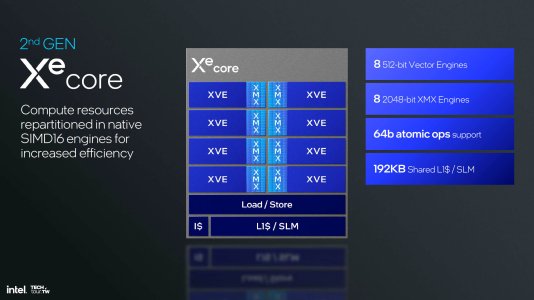

"PVC, Xe2 and later platforms have 16-wide EUs." So if Xe3/Celestial is still SIMD16 I wonder what Tom Petersen meant with following NVIDIA uarch.
Its already known since computex that xe2 has native simd16.
And i speculated in march it will have simd16 and i was 100% spot on the spec's.

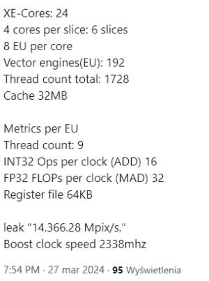

Each EU in ACM had 8 SIMD lanes so 8 FP32 operations per cycle each lane can handle one FP32 operation.
1 eu 8 fp32 (add) / 16 fp32 (mad)
Now they have native16 that fully supports fp32 i think that what he meant by fully supporting NVIDIA uarch
fp32 (add) 16 and fp32 (mad) 32

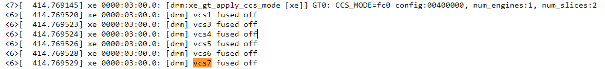

Comfirmation of max 8 slices for xe2 =32xe2 cores is max
This is a dmesg0.txt from intel bmg-1 with 8 cores/2slices. (vcs2 and vcs0 active)
