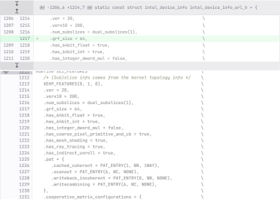

I found this mesa code today. This points to ARL-H with xe2, as gfx20=xe2 but im not sure.
Also ONE xe1 EU is 2x slower then ONE xe2 EU at half the power well at least in timespy. But 32xe2 cores = 256EU and A770 512EU. At worst 4060ti at best 4070super.
Also i still think the 56/64 variant is comming just from the mesa/linux kernel dev patches im reading daily.
LNL xe2 is already above b0 stepping since 4days ago.
Found kernel patches for G21 today for example. First mention of G21 in patchwork.
