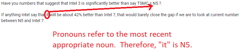

Eh, if you are going to complain about people reading right, then you should type right. I hate grammar posts in CPU threads, but you brought the reading right up.
Here is your post. Look at what "it" refers to. Heck the whole paragraph with the 42% number doesn't even include Intel 3. That, said, I got your gist.
The second paragraph is the continuation of the first, i started by mentioning Intel 3, from here the "it" aplly to it since it s the process that i question, not to be pedantic...
That just isn't how English works, but okay.
"It" decided that already.
I think you got the grammar wrong. "It" would be referring to the subject of the previous sentence.
