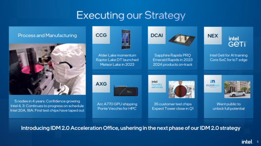

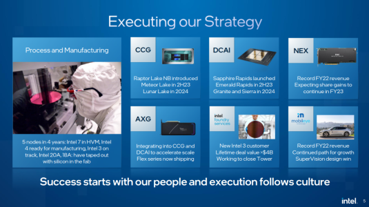

IMO, Intel was able to ramp up I4 process in 4Q22 and sell MTL by mid23.
However, delivering EUV scanner had been delayed.
In 3Q22 earnings report, Intel said "Intel 4, 3: Continues to progress on schedule".
But in 4Q22 earnings report, Intel cleverly avoided saying such expression.

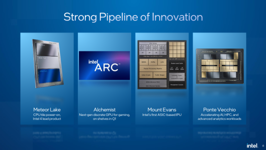

Intel announced MTL tape-in (= fabless company's tape-out) May21.
Also, Intel announced MTL power-on in 3Q21 earnings.
I think that they had enough time for debug&validation.
