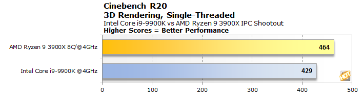

Now, they used DDR4-3200 on AMD and DDR4-2666 on Intel. That's a ~20% difference in memory speed. They also divided performance by GHz, which disadvantages the higher clocked CPU because most workloads don't scale perfectly with clock speed.
Yes it's flawed but the tester didn't understand it, so there are better IPC tests available. The one from the stilt is a lot better.

So, according to Anandtech, Zen 2 has ~7% higher IPC than CFL-R (P0).
The Stilt tests a large suite and locks both CPUs to the same core and memory frequencies. SKX-R also ends up faster than both even when you look at the ER results.
Phoronix shows that the hardware fixes going from Skylake-SP to Cascade Lake-SP provide a positive uplift in performance (a smaller penalty). They even show a positive uplift in performance going from CFL-R (P0) to CFL-R (R0).
First of all, Andrei tested both at 3200 MHz, both of them at CL16. If only people actually read the page on which they did the SPEC testing. At the risk of sounding like a broken record, I'll repeat what Andrei has said many times - testing at a lower fixed frequency artificially inflates IPC by reducing the effective memory latency. Thus, testing for IPC should always be done at the highest possible frequency the architecture was designed to operate at. IPC is not independent of the frequency at which it is measured. This means that an i9 9900T with its lower clocks has higher IPC than an i9 9900K in any workload that is memory-bound. Therefore, Anandtech's testing is correct; The Stilt's results, even if they encompass a wider variety of workloads, doesn't paint a true picture.
It's quite surprising that there are still quite a few people around who insist on not believing objective facts, decrying them using the same tired, old arguments to suit their narrative, and the extent to which they resort to these arguments is almost pathological.
Ok, when you do IPC perf/clock tests, you do it for the purpose of finding out how they'll fare in the future with hypothetical scenarios.
Stilt didn't run his chips at 2.5GHz or some odd low frequency, he ran them at 3.8GHz, which is fairly high. Even in AT tests the difference in frequency between the 9900K and 3900X is only 7.5%. The point of fixing frequencies is especially valid because for whatever reason its easy to knock off 100MHz or 200MHz when its left to the CPU to auto boost to its max. And of course when you want to see how the architecture does you want to fix it anyway.
I am going to link to two more perf/clock tests-
Zen 2 has a lead in Cinebench and other more vector and SIMD oriented code while Intel has lead in Integer. You can even see that reflected in Sisoftware Sandra tests with CFL leading in Dhrystone and Zen 2 leading in Whetstone, and also Anandtech tests. Continuing the tradition of Intel fairing better on Integer and AMD on FP.
SpecCPU2006
Int - 1.9% lead for CFL
FP - 6.5% lead for Zen 2
SpecCPU2017 Rate 1*
Int - 5% lead for Zen 2
FP - 7.8% lead for Zen 2
(Strictly speaking Integer is the better indicator of a faster architecture as ILP is higher in general with floating point code and you can get easy double digit gains by doubling vector unit resources, but as a product you have to consider both)
Based on tests it seems SpecCPU2006 is a better indicator of performance for the two architectures.
*Not to mention for some bizarre reason the tester decided to use Rate benchmark set to 1 thread for SpecCPU2017 rather than use the Speed version which is by default the benchmark for scalar performance.

It's a mistake on my part. That comparison was done with the same memory on both the 3900X and the 9900K. The general testing was done with different memory (although you could go down the rabbit hole of in spec and out of spec memory).
That still doesn't take away from the fact that dividing performance by clocks almost always disadvantages the higher clocked part. The 3900X isn't even the highest clocking 3rd Gen part. That would be the 3950X. You'll see lower IPC on it than the 3900X, so it's a disservice to Intel here.
SKX-R also wasn't tested. I guarantee that would do better considering you're looking at a 4.5GHz max boost vs 5.0GHz max boost.
