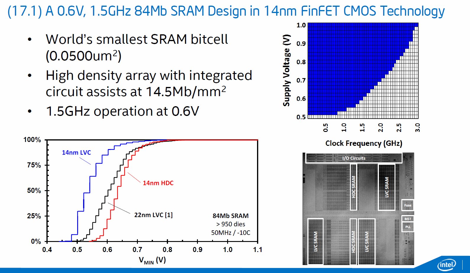

I think they are being very generous on the intel SRAM sizes there, I believe samsung quoted High density and also high performance, and that SRAM is citing samsungs High performance (low density) figures. Intel doesn't say whether it's High Density or High Performance, but intel isn't exactly known to be conservative in its predictions, so we can assume this is the best density they can get.
Also... it has been pointed out by Hans De Vries that even TSMC 20nm Planar is giving A8X much better density than Core M, despite the cited gate pitches.
11,715
2,012

The interconnect methology differences means intel get lower density than tsmc - yes - as evident from bw core m vs a8. Gate pitch and s-ram differences here is of minor importance and very small.
But Intels 1d interconnect methology also means higher yield. As evident from eg the huge server cores, where there is minor differences in size meaning no need for harvesting.
The end result is the same but Intel approach seems better for larger cores and their market - the same goes for tsmc.
You don't *actually* think the Core M v.s. A8 density comparison is at all valid, do you?
krumme
Oct 9, 2009
5,956
1,596
Its not the only example. Historically the difference have always been there go eg look bobcat vs prior atom gen.
Ofcource its different arch and eg cpu vs gpu area but the pattern is the same.
I guess you think a fast transistor is bigger? ;)
11,715
2,012
Look at the kind of density improvement AMD got with Carrizo on the same 28nm process. 30%+ improvement just by using high density libraries.
Do you not think that something like the A8/A8X is using similarly density-tuned libraries while a higher performance/frequency chip like the Core M isn't?
