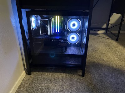

The build is finally done! I still need to install the rgb controllers so I don’t have the rainbow thing going on, and I have some stuff to help hide cables from the back of the desk in the mail, but it’s all put together. I don’t think I did too bad of a job with cable management either. What do you think

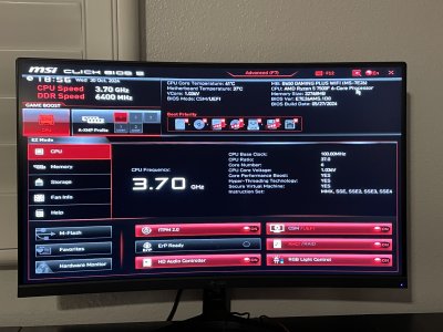

Do you have a bootable Win10/11 setup USB created properly using Media Creation Tool or Rufus?
Can't see if CSM is turned on but if it is turned on, you need to turn it off and enable UEFI. CSM is for older OSes like Windows 7 or even older.
With UEFI boot enabled, it should read the USB and boot from it and start the Windows setup.

I realized that I need a boot drive not long afterwards, I don’t but I’m going to see if I can go get one from Best Buy before work. Idr seeing csm but it shows the latest bios update as of late may 2024 so I don’t think I have an issue there.
Yeah and you need to prepare it with the latest ISO with Rufus or format and create the bootable USB directly with Media Creation tool. This can only be done on a spare PC or laptop.

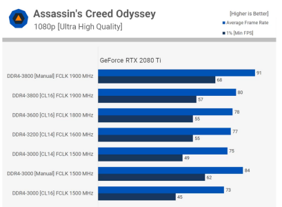

The ideal speed is 3733. You could probably get there easily by relaxing the timings to CL20.
Thanks Igor! I’m definitely still trying to figure out what a lot of this means, it’s almost like learning a new language. I was under the impression lower was better, until seeing a video yesterday that explained that amd processors don’t always like the lowest/highest numbers
28,173
19,201
Yep, AMD CPUs definitely defy logic!
It's crazy that just DDR4-3000 with tuned timings can outperform almost anything below DDR4-3800!
In your case, it won't matter that much coz Radeon drivers have far less overhead than Geforce drivers.
Still, getting that level of performance seems easy peasy for your kit if you decide to go with the DDR4-3000 manual timings.
