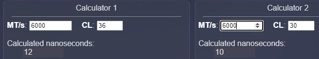

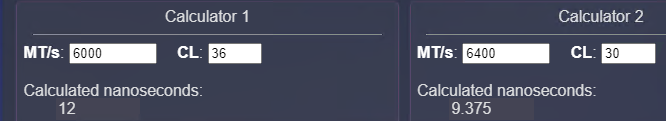

I think the CL36 RAM should be returned but that's just me. I would prefer to pay a little extra for 6400C30 RAM because
Check here: https://notkyon.moe/ram-latency2.htm
But that's valid only if your CPU/mobo/BIOS can handle 6400 MT/s. Suppose all it can do is 6000 CL30. Then things look like this:
That's two nanoseconds shaved off for every memory access. To me, that's a big enough deal for an additional 20 or 30 bucks.
I’ll have to see what the return policy from the site I ordered from is, to see if it’s worth it, and what timeline I would be looking at. Im already considerably over the initial budget I wanted 😬. Granted I could have been much better about deal shopping
I didn't notice the CL36 until you mentioned it. I think we were all picking out CL30 RAM when putting lists together.
There's always places to spend more money for a little more performance. The question becomes where do you stop? The real world differences I saw in benchmarking games on my system between various RAM speeds was only 1-5 fps once the rated EXPO frequency was achieved , certainly not ground breaking. I saw a decent jump going from base speeds to EXPO, but after that wasn't much. So I don't know how much this would really affect real use cases, certainly up to the OP to decide.
It's the kind of thing that would bother me, since I'm addicted to benchmarks. The OP shouldn't be able to notice it, unless his brain is nanoseconds sensitive :)
I definitely did read up on this stuff outside of this forum, and it seemed the general consensus was that higher numbers didn’t equate to better. I made sure the cl36 wouldn’t be a big issue and bought the Corsair vengeance because they’re reputable and I like the look.

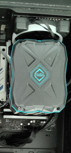

Ok I’m back with one more question, but out of frustration this time. I ordered the id cooling a620(dual tower) I was sent the wrong cooler the first time. So I am going through the refund process on that, but ordered the cooler a second time so I could have it by the time my cpu arrives. I received the wrong item, again, this time the a610(single tower). My question is, will the single tower cooler be adequate for use ? I really don’t know that I want to order a third cooler, and pay for next day shipping a second time.
28,174
19,219
I'm not much of a builder but here's my setup:
That's the IceSleet G6. The A610 looks like it might be two thirds as big which I think should be more than sufficient for your CPU.
In2Photos
Mar 21, 2007
2,626
2,794
My daughter has a 7600X with an ID Cooling SE-226-XT. Single tower 6 heat pipes. Works fine. No issues with temps.

How about you? Howz the LT720 working for you? I guess you are using it just for higher boost speeds and not OCing? How loud do its fans get?
No issues with it at all. I honestly bought it for the looks. Temps are fine. It will still get into the 90s all core since I have it running at higher than stock PPT. But it's quiet. I have the unifans set to like 30% until it hits 80C then ramp up. For most tasks it stays in the '60s or '70s.
