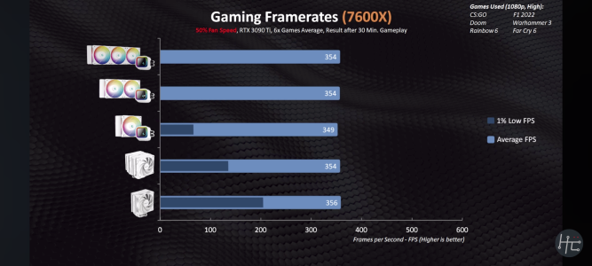

If the 5600x is anything like the 7600, I'd consider the stock cooler to be woefully inadequate (CPU saturation with the stock cooler equals sky-high temps within a matter of seconds).
While recent generations of non-low-end x86 CPUs are designed to turbo as much as they can and only reign in the turbo frequencies if they're nearing the thermal ceiling so therefore it's logical to expect that any cooling solution is going to get well-tested, I would guess that a 5600x with the stock cooler would be allowed to reach maybe 75% of its full potential while under a full sustained load.
Here's a thread talking about the 5600 (non X) and the wraith stealth cooler not being enough:
IMO if you're working within a tight budget you can probably grin and bear the stock cooler for a bit, you'll probably notice the CPU fan audibly reving up with the slightest provocation (e.g. web browsing), but I think even a small step up to a budget tower-style cooler (e.g. Be Quiet! Pure Rock 2 Slim, but preferably a PR2) would result in significantly reduced noise levels and a performance improvement.

For gaming the stock cooler will work ok, but I do agree even a $20 cooler like the ID Cooling SE-214 would be better. Hardware Canucks found very little performance difference in different coolers for the 7600X in gaming.
