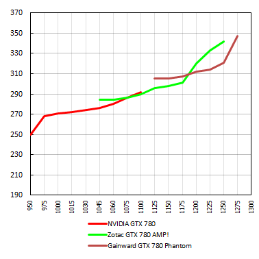

EDIT: In order to make GTX 780 perform like 290X, you will end with a card consuming about to the same power(comparing reference boards of GTX 780 and 290X). Anyone remember GK110 power consumption per clock+voltage scaling? Same history here. for 290X too.
http://www.tweaktown.com/articles/5...overclocked-reference-video-card/index22.html ( a example of what can happen, see 290X@1060Mhz and 780 Lightning power consumption)
- GTX 780 custom version have more robust PCBs with better power control and superior cooling. Even mainstream aftermarket solutions like DCU/ACX/TWFZR/WINDF have much better boards(cooling+electrics) than reference boards. GTX 780 is not an exception of this. -

Keeping gpu temperature in check - ie under 70C level, even heavily overvolted 780@1.26v consumes mere 40W more than at 1.179 stock volts.
Voltage/Clocks
Power/Clocks
So once we keep those temps down, power consumption drops significantly
Source
I could be reading this wrong, but doesn't that graph show otherwise? The 70°C 290X is pulling 218W, while the 95°C 290X is pulling 185W...
We would need to see the clocks and what FPS it is pulling to determine if that fan speed/voltage is worth it. Hard to tell just from that chart. It could be with a huge overclock and a boatload more FPS.
Ok, what that picture shows is what Tom's attempted to do to match what aftermarket 290x's are going to look like. They set the temp target to 70C which is why the fan speed is so high. At 70C this card uses a mere 8 watts more than the titan, and is probably quite a bit faster because it is likely not throttling. The lower temperature number is how much the card was likely using when it throttled to maintain the 70C number they set. They state that the 185-218 is the range of power consumption numbers they saw through the benchmark. Lowest, and max. I like what Tom's did there because it shows exactly what poeple should be waiting for in the aftermarket cards.
