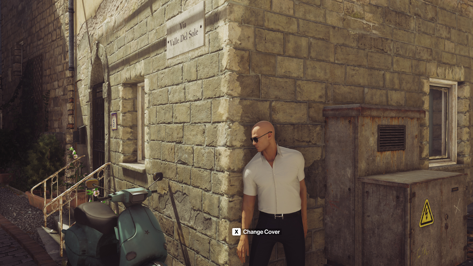

When people react to images rather than arguments, give them an image ;):
In the Fury X segment of the video, the barcode texture becomes sharper only after the character makes the first head movement. Before that it's a blur.
What does that tell us?
Barcode? Is no one looking at the drapes/curtains? WTF is going on in the Fury X and GTX 1080 that the tassels are basically blurred garbage? Did no one else notice that? The lower scoring 980 Ti is the only one actually rendering the tassels.
PCGameshardware.de saw very similar issues when they tested Hitman.
Based on their tests the issue would appear to be partly due to a faulty DX12 port (the R9 nano looks perfectly fine under DX11, but starts having issues under DX12), and partly due to a memory protection feature (The 980 Ti shows clear improvements when this feature is turned off, although it is still not perfect).
I was just preparing that, all in good time! :biggrin:
Even 980Ti gives up on proper rendering by the end of the sequence cut. See frame 4.
And that's the problem with still images. If you look at the video, Fury X has that texture just for a moment while everything comes into focus but has the best defined texture for the rest of the time while 1080 is still that way for all the time.
Above sequence starts from 20 seconds into the video.
