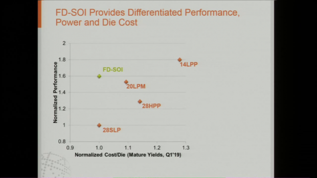

GF showed a chart about performance and cost

What customers can we expect on 22 nm FD-SOI, and why?
Isn't everyone heading for 14/16 nm?
The vast majority of silicon chips made are not on a leading edge node. 14/16nm have very high upfront design/mask costs. This 22nm process family is specifically designed to have low upfront costs (at the cost of lower peak performance and higher per-unit costs). This means it's bad for the kind of high-end mass-market products that go on 14/16nm, but it's meant to be a much better choice for all those small design firms that make chip runs that are a lot smaller than what Intel, Apple, Samsung, Qualcomm or AMD do.
It's still an open question if the node will be a success among those companies -- there is probably a lot of investment into TSMC-specific tools in them and GF will face an uphill battle to attract customers.

Ouch, projected to reach that point nearly 4 years from now!? (Q1 2019)
A lot can happen in 4 years. Like 7nm and EUV.
They promise easier design and half the mask cost today with somewhat higher per-unit costs for now and "totally going to down in the future pinky swear".
For the customers that go for this the upfront costs are what matter and 7nm and EUV are not going to bring those down...
