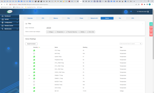

Heat pipes can move a fixed amount of heat which is dependent on the surface area of the interior of the heat pipe. They are sized based on the exterior of the heat pipe. A heat pipe can move 30w max. I think that 30w is based on the fluid flow in one direction, so a heat pipe that connects to a hot plate in the middle can move double the heat.
the 9554 is a 400w chip. 400/30 = 13.333, so you need 14 6mm heat pipes minimum.
I am using the dynatron j12 which has 6 double ended heat pipes, giving it a maximum heat transference of 12*30, or 360w. It is rated for 320w, which is probably appropriate. When you go looking at heat sinks, count the pipes, it matters.
the freezer one earlier still has 6 heat pipes and adds a fan. Since your limitation is due to the heat pipe max not the fins, that will not help you. I will post later if I see one that may work.
A water cooler may be helpful as that does not have the hard limit, and is just based on surface area at both ends and a temperature differential.

I have 2 of the first 2 shown. The first one keeps them at 93. The second keeps them at 87c, but the second one has cheap fan mounting hardware, and I had to hardwire it (literally) to keep it fro making noise on of the the 2 I have. I want a Noctua one !
I have one of the ones in the second link I think, but its a jet engine.
