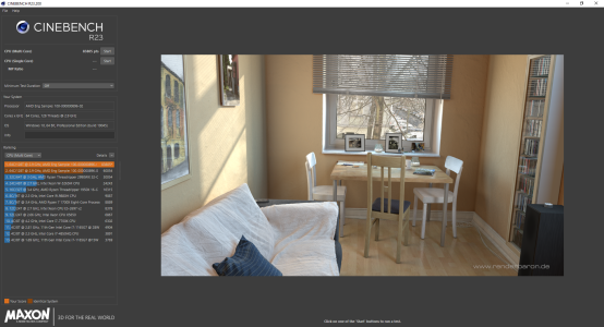

I have another 9554. If I only had $2000 for the motherboard and $924 for 12 more sticks of ram I could set the world record for CB23, but at stock on air at 166k ! And it only runs at 3.5 ghz. Trounces the 3495x at stock on air.

OK, I don't get this. Everybody is excited about a 3495x under LN2, which would never happen in real life (as real usage), but I have all but proven that 2 9554 64 cores at default on air (like a server would actually be) could beat that world record. So do we care about fantasy or reality ?
Reactions: scannall
cellarnoise
Mar 22, 2017
859
450
I hope that Intel picks up the pace!!!
AMD looks to be slowing down timelines, but who knows?
9554 would do better with better cooling of any kind?
I want to de-lid one of my 7950x, (I think) and direct die cool it. Looks to add a lot of performance.
Just ran cb23 on my main box at 150w limited. 36,282 MC. I think 9554 has a lot more in the tank!
This is with my RAM detuned a bit and with my case fan profiles on super quiet. Though I am using a 420 arctic aio on the cpu.... And it has been mostly at idle for a few hours.

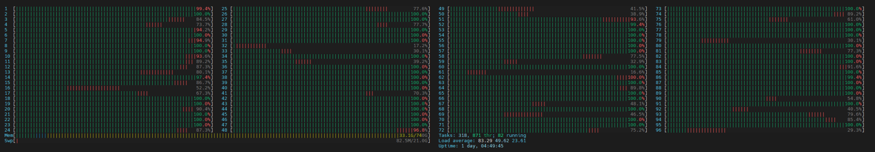

htop, in the background Android 13 AOSP build running. Some pass are really ST bound and here Genoa is much faster than Milan.
I see... What do the red portions of the bars mean? And why are some portions of the percentages shown in red while others are in grey?
DisEnchantment
Mar 3, 2017
1,779
6,798
Not a builder, but you are renting this instance from the cloud ?
Yes, I rent it from the cloud provider, I travel a lot so it is easier for me to access it from anywhere. I have multiple 2S 7571, 1S 7R13 and 1S 9474F from same provider.
I don't know why I still have access to the older instances but I am super happy with Genoa. I guess it is in my subscription, they wont remove it until I remove them from the Mgmt dashboard.
