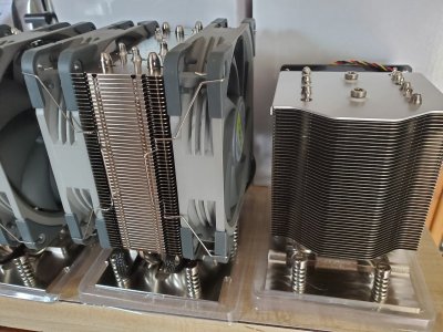

OK< This is more like it. Do you think the HSF on the left will cool better at 400 watts and be quieter ?? I bet it will.
I think it will be quieter at its 100% fan speed, than the second one at 50%, through it's relatively noisy at its pick 2200RPM.
Otherwise its dead silent.
I would prefer the radiator base to be larger and higher but they targeted the whole system to be almost not more than a socket size,
preventing any clearance issues with the DIMM slots in advance. This however forces the airflow direction through the long side of the socket,
w/o 90 degree rotation possibilities.
Meantime I've added side mounted 120mm fans to blow air on the RAID card and got 10 degree reduction on the ASIC and controller. Enclosure temps left the same,
which is far less effective from my classic direct from bottom fans mount(20-25 degrees reduction, incl the enclosure).
This required to connect them to FAN-A or FAN-B and activate Heavy-IO profile(Otherwise Smicro board ran them @550RPM which is too low and didn't make any effect) which put them at ~1200RPM and added slight noise from those.
I've added two additional 120mm fans behind the board to blow air on RAM sticks - This experiment failed, as RAM temps remained at 42-45 degree mark.
This probably has to do with CPU cooler fans blowing the hot air on the top modules, making the central area relatively hot. This is further complicated by current lack of exhaust fans, creating positive pressure.

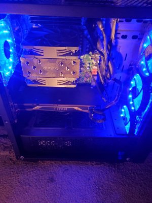

The 9654 has been running 68-74C with the fan at 3500. I will report back after the change
OK, this is just the first temp reading, but its 69, same as the lowest before. But 2 fans at 2100 and I can not hear anything. Remember, I am sort of deaf, but can hear fans pretty well.
Edit: BUT CPU speed is 2821, I think faster than it was before at 2700.
