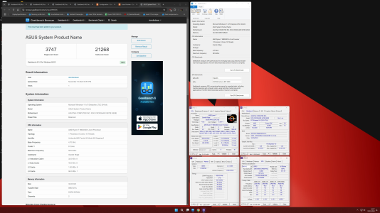

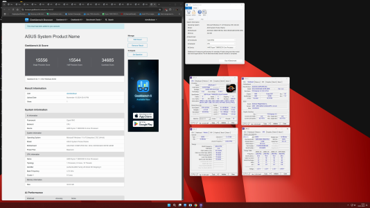

Det0x
Sep 11, 2014
1,484
5,089
Tuned 9800X3D
Not too shabby for a 8core X3D chip 🤣
Also did a Geekbench AI run :innocent:

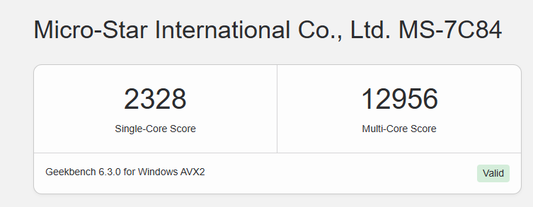

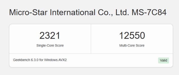

28,173
19,210
File compression, object detection and background blur are either hindered badly by SMT due to partitioning of core resources or the extra threads are getting bandwidth starved. What's your RAM speed and timings? Could you try getting to 3733 MT/s by relaxing the timings and do another comparison?
