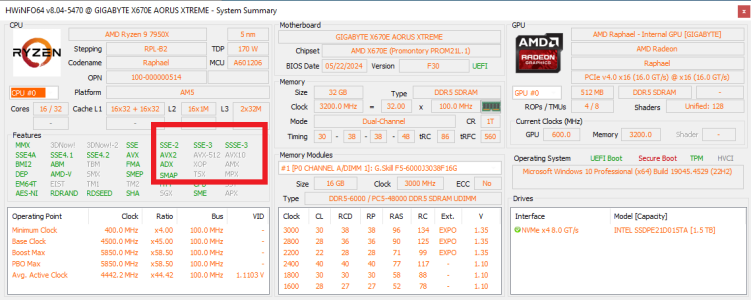

HWINFO shows AVX512 support disabled when I disable it in the UEFI, so I can only assume the UEFI disable works correctly and there is indeed no meaningful change in score without it.
That's not what @igor_kavinski and I found on Intel chips. Without access to any Ryzen 4 machine, I can't check what's going on.

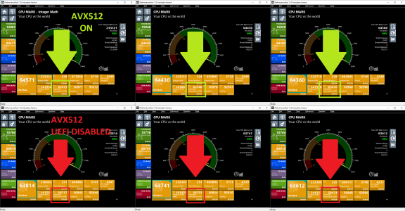

I think I've verified the UEFI AVX512 disable works. Passmark 11 uses AVX512 in the CPU Extended Instructions test. I did 3 runs with it enabled and disabled. Note, Passmark says the fallback in this case is FMA, not AVX2.
~63,500 AVX512 Enabled
~58,600 AVX512 Disabled
