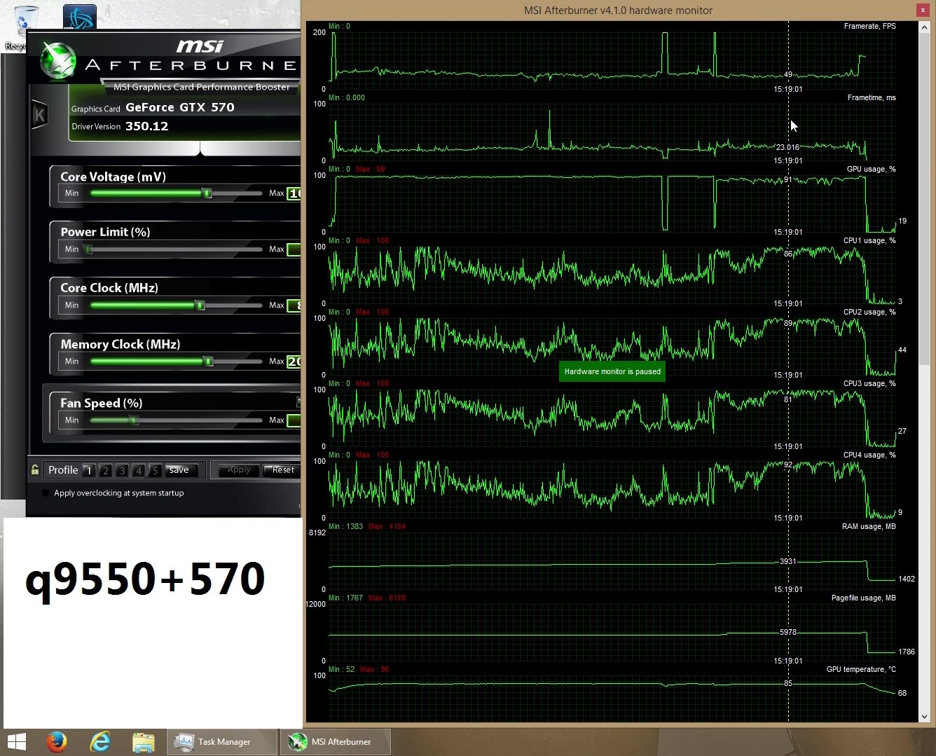

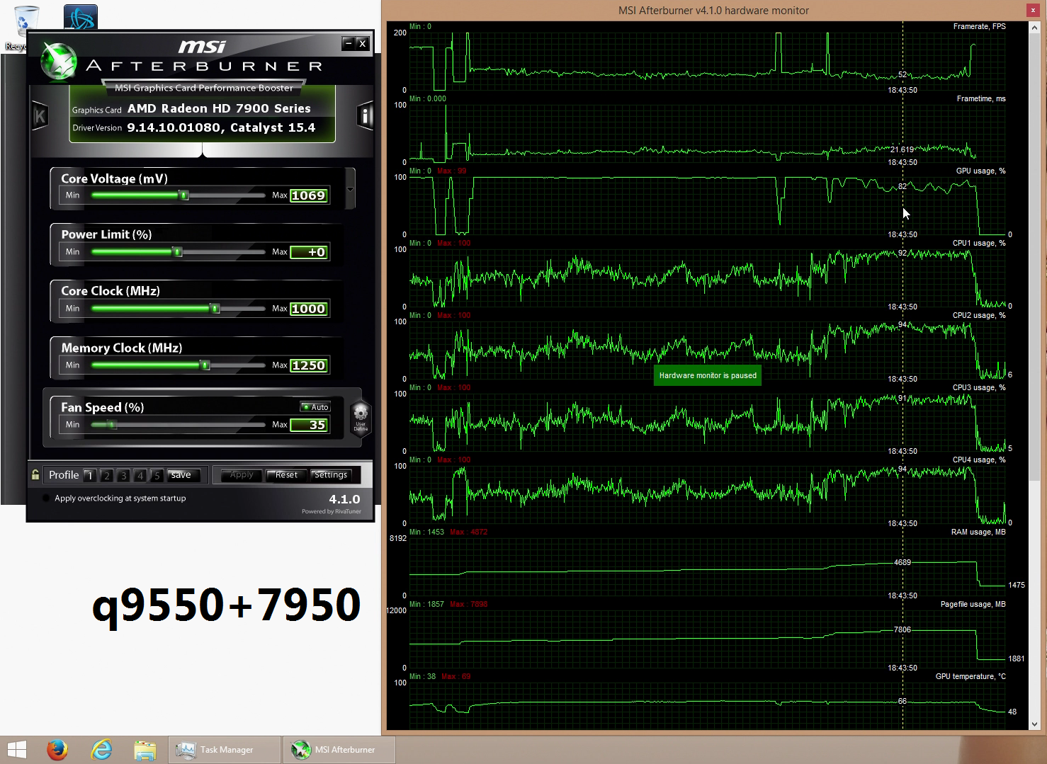

GTX 570 vs 5850 on the Q9550, quite high settings (1480MB vram needed), no MSAA, 570 has one degree higher tesselation setting. This discrepancy occurred because I figured the 5850 would manage the same settings and while it did for the most part, the higher tesselation made it stutter a lot, so I had to turn it down a notch.
Grand Theft Auto V 1920X1080 v.high(-) GTX 570 @850Mhz Q9550 @4GHz - 56fps
Grand Theft Auto V 1920X1080 v.high(-) 5850 @950Mhz Q9550 @4GHz - 38fps
Now the interesting part comes in exactly this last test, because it has again to do with AMD's driver higher cpu needs.
Here are two captures from their respective videos, that show the framerate, along with the cpu usage.
You will see that the q9550+570 combination can produce ~50fps, while the 5850 is even more severly cpu limited and the system can only achieve ~30fps. 😕

Soo..in succession to the above post and since I was fairly disappointed by the 5850's outdoors framerate of 30fps, which also showed cpu limits, I decided to do the same test, same settings, same system on the 7950 this time.
Grand Theft Auto V 1920X1080 V.High(-) 7950 @1Ghz Q9550 @4GHz
In all honesty, since the gpu load was not at max and cpu load was very high, I thought I was seeing an AMD driver overhead issue. However, I was mistaken and I recall my previous assumption. After doing benchmarks all these years, I should have known better.
So here are the q9550+7950 and q9550+5850 graphs from MSI AB, of course on the same system.
Also side by side comparison, of the 7950 vs the q9550. Both systems do not go to max gpu load, while having very high cpu load, but the end result is totally different.

To put this in perspective, my 570@850Mhz scored 56fps in my benchmark run and the 7950@1Ghz with the 5850 settings, (which means one less degree of tesselation setting), only 60fps. Both on the Q9550 and also note that the gpu usage was at max for at least 2/3 of the benchmark, which was indoors/low cpu.
The weird part comes in the fact the 7950@1.1Ghz (I had to use lower gpu clock on the Q9550 because I used my second 7950, which does not OC well), paired with my 2500k and using my GTX 970 settings which are everything maxed, no MSAA, scored 62fps.
Meaning better score for only 10% more clock, with significantly higher settings.
Here are all the graphs I am talking about in this post (repeated above), so you have a picture of what I am talking about.
2500k+970@1.5Ghz+7950@1.1Ghz=maxed settings, no MSAA
Q9550+7950@1Ghz+570@850Mhz=same settings with each other (I call them vhigh minus), with one degree higher tesselation setting on the 570
These settings the 570 cannot even dream of, while on the 7950 the game is playable.

The take home message is that a strong GPU needs a strong CPU to drive it, particular for this game.
Computerbase.de did a thorough test with 2 cores, 2 cores + HT (4 threads), 4 cores, 4 cores + HT. They show as long as its a real 4 core, it will keep a 980/R290X bottlenecked. 2 cores got massively worse performance for both 980/R290X. 2 + HT (i3) improves it a lot but still below 4 cores and they noted, the game stutters with 2 or 2 +HT, so 4 cores is minimum.
@psolord
What you showed us with the Q9550 result at 4Ghz is that you are running into the CPU bottleneck, it appears to be at ~60 fps which is very good for such an old CPU. Take a look at the GameGPU.Ru charts for modern CPUs, you see that many of them struggle to be 60fps+ with only newer i5/7 Haswell capable.
