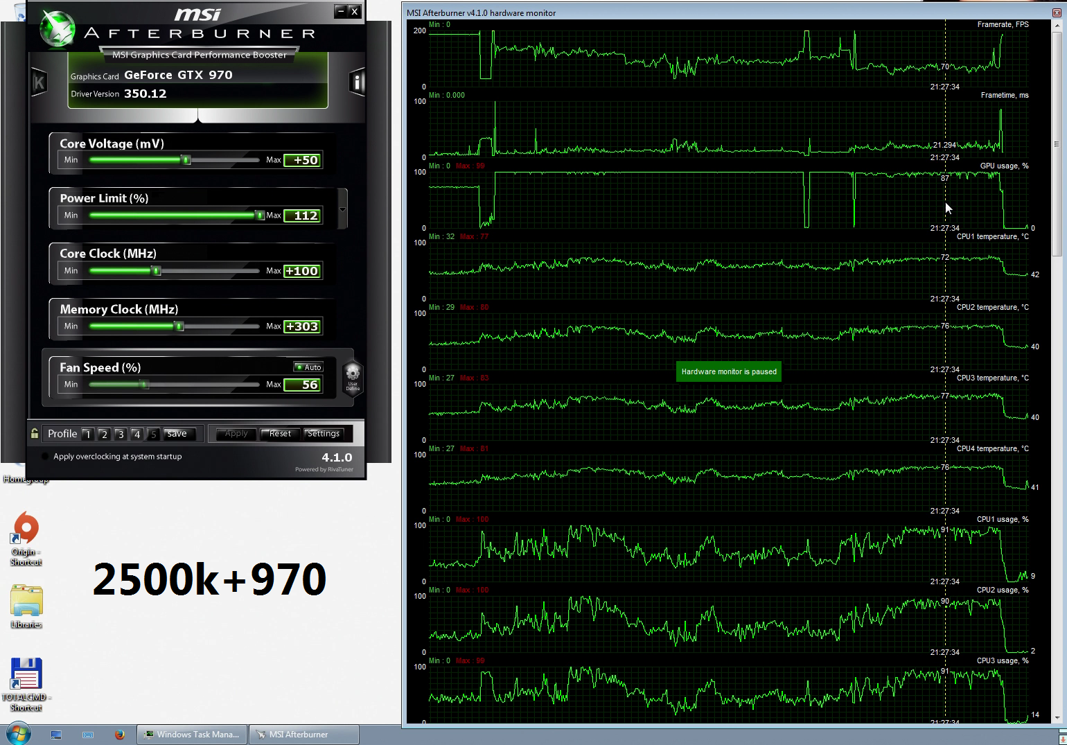

Now the interesting part comes in exactly this last test, because it has again to do with AMD's driver higher cpu needs.
Here are two captures from their respective videos, that show the framerate, along with the cpu usage.
You will see that the q9550+570 combination can produce ~50fps, while the 5850 is even more severly cpu limited and the system can only achieve ~30fps. :confused:
Here is a side by side comparison, with the two runs at the same location. You will need a fast internet connection and you may want to increase to 720p for both windows, to see the OSD better.
The same thing happens in the 970 vs 7950 on the 2500k.
For about the same cpu load, the 970 is producing 65+fps while the 7950 less than 50fps.
I think it will be best to do a q9550+7950 test with the 5850 settings, to see if this 30fps limit will also manifest in this configuration. :confused:

@pslord, something doesn't stick. Amd setups have lower CPU usage than nvidia setups according to the screenshots you posted.

The GPU maxes out so the cpu can't give you its maximum performance, that's called bottlenecking.

Yes, but he stated there is move driver CPU overhead shown on these graphs, but in reality it doesn't show any of that.

My friend Erenhart, look closely at the 570/5850 graphs, at the part where the mouse pointer is. This is the cpu limited part.
The 570's cpu usage, is like 5% higher than the 5850, BUT the 570 system is spitting out 50fps while the 5850 is giving 30fps.
Isn't that a clear indication of AMD's driver cpu overhead?
In any case I will test the 7950 on the Q9550 tomorrow, with the same settings as the 5850 and if it produces worse results than the 570, I will be greatly disappointed.

These graphs show usage over time,you will have to look at the actual threads and see if the amd driver thread is bigger than the nvidia driver thread and if it is then by how much and in which scenarios.
You will have to run process explorer/hacker to see this.
Like in this video here you can see a atidxx64.dll (ati dx x64) thread that changes depending on what is shown on screen.
During that part, the 5850's 1GB vram may be hurting it a lot, we can see it's failing to be loaded at 99% GPU, the 570 is still running max loaded.
This suggest vram swap, which causes fps tanking.
As to the % CPU usage, the graphs just shows higher for NV because their GPUs are stronger so they need more grunt to drive it. Otherwise its not showing what some of you claim, more driver overhead.
To do that, you would have to use setups that are driving similar FPS to ensure the test is proper. ie. 970 vs R290X would be close in performance according to benches from various sites. Once the FPS are similar, then compare the CPU usage.

yes it's an interesting to analyze, VRAM could be the problem here since you are comparing 1.28 vs 1.0 GB cards at the very limit,
it's clear that the 5850 GPU load is not being fully utilized and the framerate is much lower with the same CPU and the CPU load is lower overall because the framerate is lower, it looks like VRAM could explain this as you said, but it doesn't necessarily mean it's not more CPU limited on the 5850 just because is not loading more overall (considering all cores), since we know AMD's DX11 overhead is a lot more critical, and GTA V should be bad case for it?
http://images.anandtech.com/graphs/graph8962/71451.png
http://images.anandtech.com/graphs/graph9112/73050.png
and the CPU/driver bottleneck could mean lower load for other CPU work?
the 7950+Q9550 and 970+q9550 vs 7950+2500K-OC and 970+2500K-OC could help if it showed a significantly different performance loss with the 7950, but the 970 is much faster and it can also cause confusion (perhaps downclock the 970 to where it can match the 7950 OC in most GPU limited benchmarks!?)
