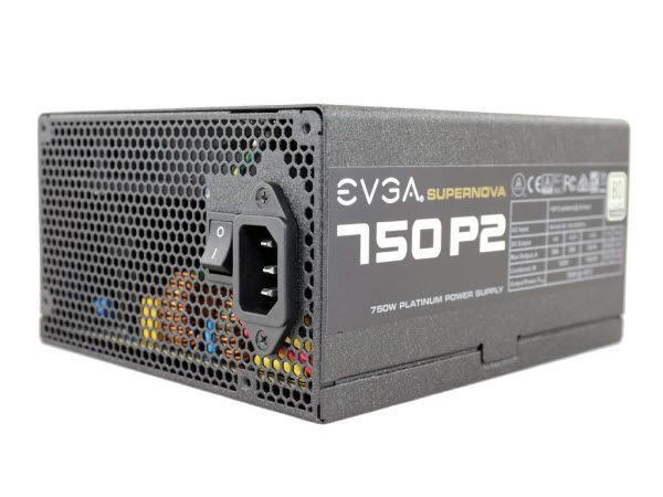

That is a sweet power supply, a good buy. Check out the power graph for it here:
note:
90% efficient at 150 watts. With your 3070 having a advertised average wattage of 220w by itself, it would seem your definitely in the efficiency curve.
Ignore the others, your power supply is excellent for this. The advice you received about getting at least a 80+ gold was correct.

You know your going to add another GPU in, right? It took 7 years for me to do it, but I eventually added a 2nd GPU. My 7 year old 650watt evga psu is happily pulling 480 watts off the wall as I type this.
notes:
86% efficient at 75 watts
88% efficient at 100 watts.
91% efficient at 250 watts.
You know your going to add another GPU in, right? It took 7 years for me to do it, but I eventually added a 2nd GPU. My 7 year old 650watt evga psu is happily pulling 480* watts off the wall as I type this.
*210-GQ-0650-V1 running rx6900xt + vega56 + 4790k + cooling as it mines** eth + me using the computer
** 91.53 Mh @ 480w /w .13 kWh = $5.75 profit per day or $2099.45 per year
That's a different PSU that is Platinum rated.
Blah!
round 2:
which annoyingly cuts the graph off at 20%, or 150 watts.
but that likely does not matter, as he is using a 3070 which is >200w card.
(I will go up and correct my original post, eventually)
