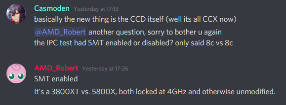

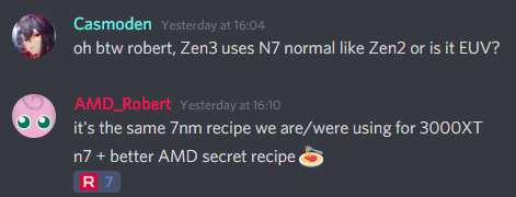

It's a little less than 2 years since the thread on design changes in Zen 2. It's unfortunate that even a month before the public launch of the first Zen 3 chips we still don't get any meaty information, but with the event we at least got some rough outlines which areas were changed and what their impact is. I hope AMD will fill in the interested public come time.
The 19% IPC improvement broken down into the different areas:
Doc used his pixel counting skill to come up with these numbers:
  • +2.7% Cache Prefetching
  • +3.3% Execution Engine
  • +1.3% Branch Predictor
  • +2.7% Micro-op Cache
  • +4.6% Front End
  • +4.6% Load/Store
The first and essentially only Zen 3 leak, unified L3 cache per CCD, was confirmed:
  • Advanced Load/Store Performance and Flexibility
  • Wider Issue in Float and Int Engines
  • "Zero Bubble" Branch Prediction
More technical details to come, hopefully soon.
