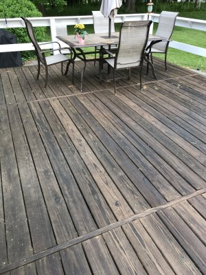

Our deck is roughly the same size as yours. I split it up into three sections. This keeps the butt ends attached to a full joist. You would need to add joists/hangers to achieve this. The deck boards were installed tight 5 yrs ago

If you split the deck down the middle there are no seams, just butt joints.
Oh I like that look. How did you install that separator board? Literally use hangers on each end?
when you say "installed tight" I assume you mean that you left zero gaps when installing and over time, the boards shrunk leaving that ~1/4" gap?
I simply screwed a 2x4 (may have been a 2x6) to the Joist up the depth of the deck board, then added a Joist on the other side, and yes the boards were installed without a gap.

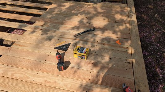

If it's in the budget, use a foil faced tape to protect the top of the joists. Also take a look at camo screws for putting the new boards down, it's a much cleaner look.
I just realized today that as I started laying down the deck boards yesterday, I forgot to use the tape! I will use it from here on out though. I have it on exterior joists at least

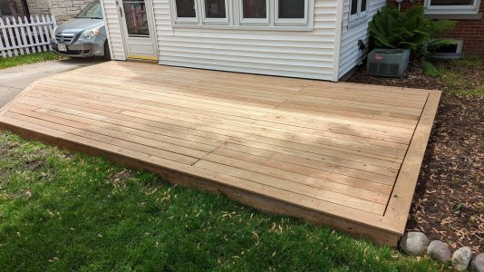

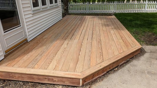

Dropped the last boards in this weekend. Turned out better than I thought it would based on my lack of experience and general knowledge. Overall, I'm happy with the results.
Would have been nice to have an actual tracksaw to cut the end boards where they meet the border boards, but I got it pretty straight with a chalk line, clamped 4ft level as a straight edge for the circular saw to run against. The varying width (especially towards the ends of the boards) and curves in some boards drove me nuts. You can see a few spots where the gap is just much larger than elsewhere.
I ended up being able to fit all the boards in the field without having to rip any down too. So all that previous discussion was for nothing 🙂. As a fun fact, I ended up literally 5 screws short... so I need to buy a box and get those in too.
Now I just need to wait for the wood to dry out, and get to staining. have to do a little varmint proofing around the edges still and then backfill the dirt.
