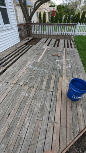

We've lived in our house for 23 years and this deck should have been replaced 24 years ago. Due to time, money and "gusto" constraints, I've just replaced boards here and there over the years and did a half-assed job of it. I was planning on doing about 1/3-1/2 of it this year, but as I started pulling up boards, it was just too far gone and I knew I'd neve be happy with the end product still being 1/2 shitty.
So I started in today pulling up all the screws... there are so damned many. And so many are bent or stripped, it's just tedious and slow.
It's roughly 17x22' I plan on just using cedar toned PT 2x4s. I'll get rid of that railing in the back of the picture. On the other side of that, under that flowering tree, I planed all wild flowers last fall and those appear to be coming up nicely already. I want to put a picture frame border around the deck - 2x6" PT. That's going to be the "hard" part for me. Going to need to add blocking on the 2 short ends and one of them has a corner non-square corner as you can see in the lower right of the picture.

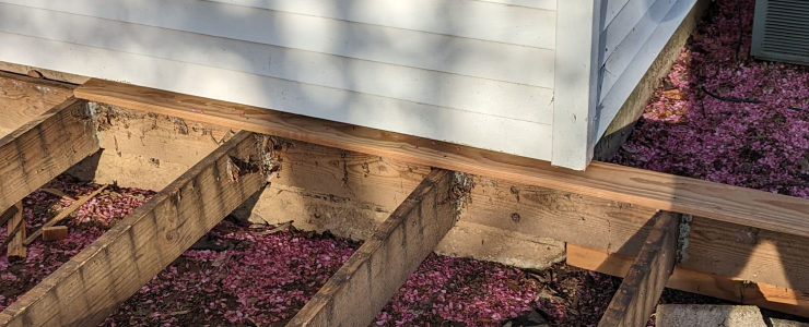

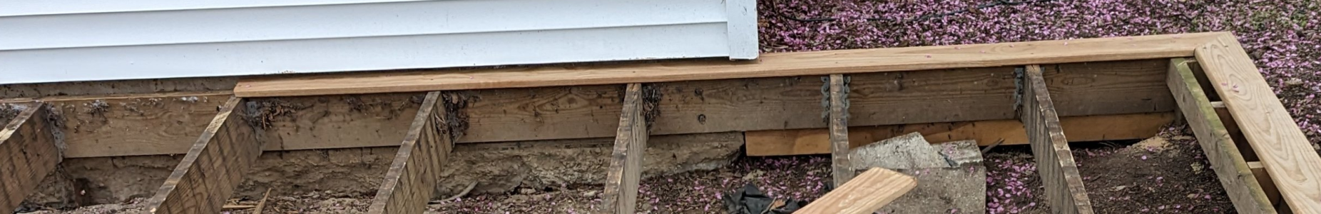

Right, I get that's how it would normally be done, but as you can see in this picture, the border board against the house has already be ripped down. So I was measuring the inside to inside of those two outside boards of the picture frame.
Please ignore the mistake on the blocking in that front section on the right. I thought 2x4 width would be enough, but the border board covered most of it. I've since added some additional blocking to support the fields boards once I lay them.

Pull the border board that's against the house.
While I get the idea of the border board, placing/spacing the rest of the boards will be difficult...and he might end up with an awkward rip somewhere that it will really be noticeable.
