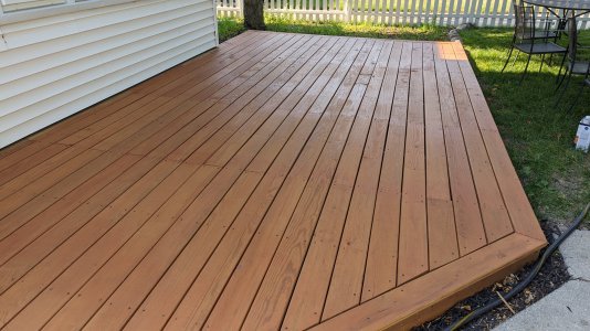

Deck rebuild 2023

Thanks!
It's a normal (small) step up. Been that way for 15+ years and hasn't been a problem as of yet.
Would have been nice to have an actual tracksaw to cut the end boards where they meet the border boards, but I got it pretty straight with a chalk line, clamped 4ft level as a straight edge for the circular saw to run against. The varying width (especially towards the ends of the boards) and curves in some boards drove me nuts. You can see a few spots where the gap is just much larger than elsewhere.

Yeah - I'm not overly worried about it. Just you know how it feels when you step back and it's not straight right away...

All in for the lumber, screws (they add up!) and tape, it cost me about $700.
I did buy a new circular saw too, but I'm not counting that as it obviously is used for a lot more than the deck construction.

I have yet to stain/seal (and then post final pics. We had a long drought here and I was going to stain/seal it as I thought the wood was ready. Now we've had like 3+ days of just constant, slow soaking rain. So it's wetter than the day I bought it. I know it's not *really* getting ruined being unsealed, but it's making me nervous.

Yeap - going Thompson's Water Seal most likely. I know a few that have used it in the past and it has very good reviews/ratings/etc.

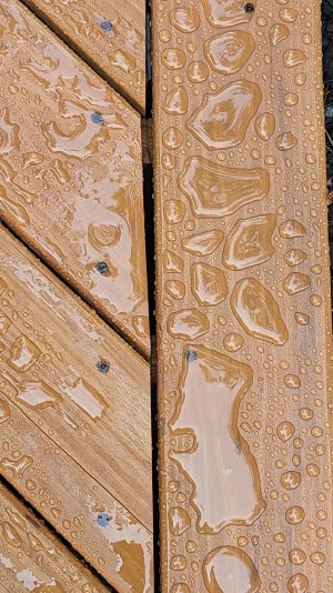

I just wanted to post some "finished" pics now that I have it stained/sealed. All in all it turned out as good as, if not better, than I had hoped. There's lots of "mistakes" as I previously mentioned, but I LOVED the project and learned so much. Thanks to everyone for the tips and suggestions and help along the way. Truly rewarding creating things with your own hands. I love tackling these things around the house every summer.
Gotta love seeing that water bead up. But damn if I don't hate that shrinkage that screws up the nice straight line. And one of those boards already cracked!

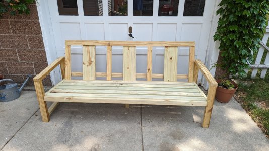

and I think I mentioned earlier that I may start in on building a couch? Well I did...
LOTS of mistakes there but learned a lot more again. Still have to sand (should have done that before building) and stain. There were some serious complications too with the 2x3 and 2x2 that I purchased not being normal dimensions which threw everything into a tizzy.
NIcd! Hmm, wonder why that board cracked so soon. Not even through a winter yet.
End grain cut. Pre prime/stain. Pre-drill. Hand nail/ screw.
That's common. The only way to limit cracks and splits is to use hand selected premium material and pre drill everything, or use a composite decking.

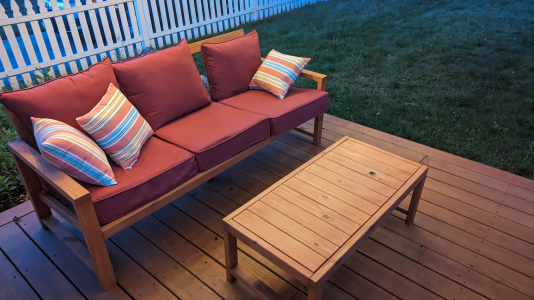

I finished the couch and made a table too (I've learned a lot of tricks and things along the way!) REALLY enjoying the work. This is woodworking stuff that I always dreamed of doing
I have some wood left and will be working on a matching chair next
Then I will build a proper work bench/table in the garage too 🙂

Sweet! Nice job man 👍
