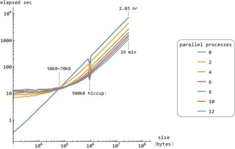

Here's the results of timing tests over a large range of problem sizes.
Note how poorly my current parallelization approach is for target (the strings to be searched) sizes less than about 70kB.
Also notice the hiccup that occurs at 900kB. It appears to be hardware related.
