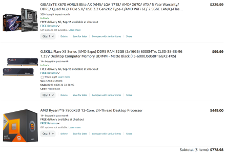

Of course you can.

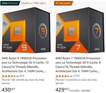

Buy those (it's a 32Go 12 core modern system). The CPU has 6 cores with a 96Mo of extended L3 cache (Vertical cache) and the other 6 cores have merely 32Mo of L3.
It'd be veeery interesting to see the differential between the two.
Incidentally in France we've reached peak comedy from performance paranoia: an 8 V$ core is now 60 cents away from a 6 core V$ with another 6 core strapped to it.
50% more cores and only mild drawbacks at having (and you don't really HAVE to either) to deal with inter CCD latency or occasionally set an app to "prefer cache" to shove it onto the correct CCD.

That's 20% of the cost of a warrantied system complete with liquid cooling. Then I'd need to purchase a CPU-locked Wolfram license to use it. Overall, a very poor use of my resources.
