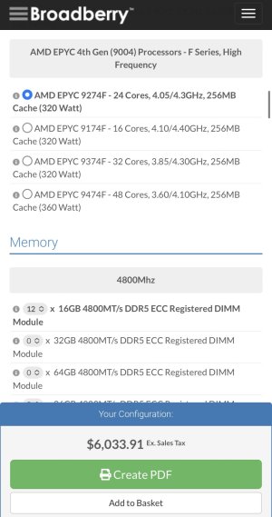

I know the “AMD Epyc” angle has been somewhat discussed to death, but I did want to point out there are system builders who could get you into one with 12 channel memory for not far over the $5k.
The “F” skus are frequency optimized and have good cache, in this case the 24 core is actually $1000 cheaper than the 16 for some reason.
You would lose some clock speed yes, but the performance per clock on these CPUs is quite high. And then you’d be gaining a massive amount of memory bandwidth.
For whatever reason, configuring these sort of custom Epyc builds seems to be much better value than the equivalent Threadripper.
From what I understand, the low core count Threadrippers also cannot really take advantage of the full memory channels whereas any Epyc CPU should be able to fully saturate all 12. In my opinion, it’s quite affordable for what you get. I did not add hard drives etc yet. It’s only another $800 to upgrade to 12x 32 gb RAM for 384 GB total. IMG_6663.jpeg
These CPUs are based on AMD Zen4 architecture. Zen5 is around the corner and may bring large uplifts. Maybe something to consider when you do need the really large dataset!
I have no experience with this system builder just wanted to provide some option. I know all this because the 24 core F CPU is one of the best value for CFD simulations, with the high frequencies cache and 2:1 ratio of cores to memory channels.

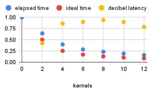

Yesterday I ran my first benchmark on a "standard" target lengths of 15MB with 2 targets and two queries. For benchmark purposes, I turn off Windows update, lock screen, etc. Here's the results. Today I'll run a broader test with target lengths ranging from 10kB to 10MB.
In the plot:
elapsed time = 1 corresponds to 2.36 hours.
ideal time = 1/#kernels.
decibel latency = 10 x (elapsed time - ideal time) x log10(#kernels).
If you invert the plot of elapsed time, to runs per hour or the like, and make the x-axis logarithmic, you might get both better resolution and an idea of how it's following Amdahl's law.
If it fits well that might give you an idea of how it would perform on more cores.

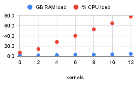

Here's some additional data from the test that produced the chart above. At 12 kernels I'm approaching the maximum processor load, but there is plenty of memory available (I currently have 128GB). This indicates that for the given problem size, I could parallelize at a higher level without impacting memory resources. For this reason I'm currently running a performance tests across a wide range of problem sizes to determine where parallelism paradigm shifts might be warranted.
From your earlier post, it appears that your parallelism tends to hit a wall around 8 processes as scaling really falls off. I don't necessarily think that adding more cores or processes beyond that is going to help much. Profiling the runtime operation of the whole system is becoming more necessary at this point.
