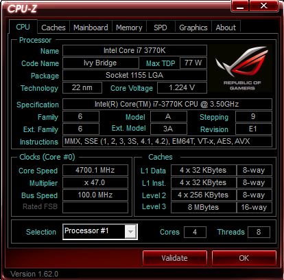

CPU: Intel 3770K @ 4.7GHz 1.224v (de-lidded)
Mainboard: ASUS Maximus V Formula

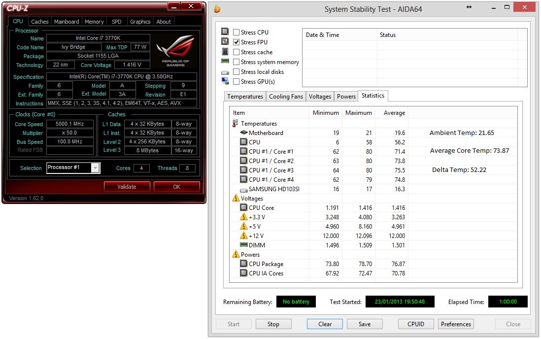

Liquid Ultra
Liquid Pro
Liquid Ultra has a delta temp of 3.1c lower than Liquid Pro in my system
3770K @ 5GHz 1.416v
Liquid Pro
Liquid Ultra
This time Liquid Pro was 1.71c cooler than Ultra.
If we use a +/- 2c margin of error there is nothing separating these two compounds. Liquid Ultra is better to work with. I wouldn't use the cotton tips that are supplied with Liquid Pro because I found more compound stayed on the cotton than on the IHS. Also there is the risk of cotton fibers sticking to the die or IHS which would impact temps. I used the brush that is supplied with Liquid Ultra which makes the application very easy.
Cleaning is another issue. Liquid Ultra simply wipes off but Liquid Pro often forms tiny balls which when accidentally smeared leaves quite a big mess. I had the stuff all over my fingers by the time I finished wiping it off.
If you are using one or the other than stick with it. There is nothing to gain by switching.
