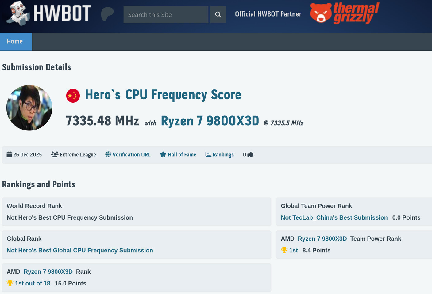

What are you using for the base? Because the highest 9950x3d scores of 814 reflect some sort of tuning / overclocking.
Default 9950x3d may be in 775 range, which would make 1072 ~38% uplift.

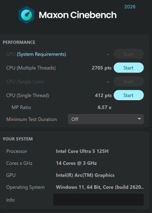

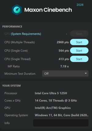

Here's my Core Ultra 5 125H (Zenbook 14 OLED) with HT on and off. The 255H in their results database must have the puniest cooling ever for me to beat it wil HT on despite it having two more P-cores and the Lion Cove/Skymont advantage. I also see why Intel wants to be rid of HT for consumers; the difference between it on and off in a laptop is miniscule.
HT brings 36% more performance in your ST vs SC results. Not that bad. The issue here is that the 125H has only 4 cores with HT.
Of course if all cores had HT, it's likely you wouldn't get 36% more MT performance due to other bottlenecks, but I'm not sure your result is enough to dismiss HT even on a laptop.
eriksp92
Mar 5, 2023
8
7
51
This is true, but if they're to keep to their strategy of P- and E-cores in a single chip where the e-cores are designed without HT (and are more numerous in all SKUs) in mind, HT won't add much more than 10 percent at best, and I imagine the scheduler complexity is a nightmare. Redwood Cove is also designed with HT in mind, so I would assume that Lion Cove has a front end designed to keep the core better fed. But I'm truly an amateur, so I claim no authority here!
Reactions: Nothingness

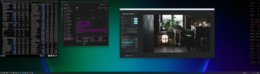

@Hulk more data lmk if you cant read out of SS.
HWinfo was only open for the ST test.
128GB 6000 34cas and 7950XTX w 550W bios but set at stock for test same with CPU 9800X3D ECO mode on default. Only EXPO turned on.
Tests used about 28GB ram, and GPU was at IIRC just over 16GB.
Below is GPU with undervolt OC and mem OC, gpu avg takes a hit on mhz from task manager compute image. Never hit 550w on RHS graph.
About 2k point increase.
EDIT:
So changing the TDP from eco to 105w, made little diff if not slightly lower, but made large impact on GPU score 61806 to 66352.

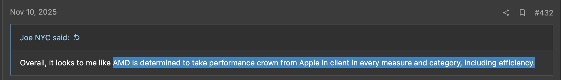

Joe NYC
Jun 26, 2021
4,275
5,960
How is that even remotely the same and why are people upvoting you? People are are upvoting misinformation just because it makes AMD look better.
It's probably the difference between sober analysis and a crack pipe that people were upvoting.
This is what you said. Read the post again. Zen7 would need to increase efficiency by 7.2x over Strix Halo to match a theoretical M8 in Cinebench 2024.
I just calculated what Zen7 would actually need to do in order to beat an M8 in speed and efficiency, given that it's not an M4 that Zen7 would go up against. It'd be M8.
And you made this projection, in the same post based on this assumption:
"M4 Pro is roughly 52% faster in Cinebench ST and 3.6x more efficient than Strix Halo."
Which is clearly a flawed assumption. Neither of the two (performance and efficiency) hold true when you do a "sanity check" by checking MT numbers.
So, you started with flawed assumption of +360% efficiency, doubled it and ended up twice as flawed +720% efficiency that AMD would have to make up.
It is a good idea to do a sanity check on any claim that looks insane, and MT is such a sanity check, because in MT test, the power consumption of the cores overwhelms all of the "noise" that exists in ST test. And that (including in current version of Cinebench) shows that your assumptions are off by an order of magnitude (10x).
Apple is leading, but by 1/10th of what you thought.
Joe NYC
Jun 26, 2021
4,275
5,960
I agree. Hence, I wanted to show how silly it was for @Joe NYC to say Zen 7 was poised to take the performance and efficiency crown from Apple.
I said "is determined to", which is an aspiration. Poised means more like inevitability, and that's not what I claimed.
Hulk
5,428
4,167
EDIT:
I can't extract your cpu average frequency from what you posted. You would need to watch in HWinfo during the 3 tests, or better/easier lock down max frequency in Power Plan.
