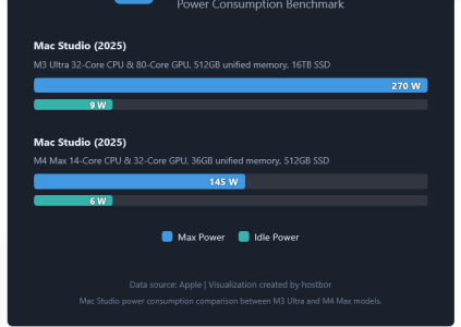

The M3 ultra mini PC pull 270W, given that idle power is 9W this make a 260W delta,
so the CPU consume roughly 200W, hence in CB2026 despite its 32 cores and better process it s barely 20% more efficient than a well cooled stock 9950X3D.
Dunno what was the load because those numbers are provided by Apple, but as a hint
NBC tested a device with a M4 that was supposed to be set at 50-57W, yet the measured delta in CB was about 90W, wich is indicative that the actual CPU power is more like 70W
than what is advertised.
Both sides here are wrong but I’ll just say Apple doesn’t advertise TDP because it varies based on load and application.
Also the M3 Ultra is more like 140 watts for the 24P+8E CPU in Cinebench not 200 watts. Based on M3 Max wall power.

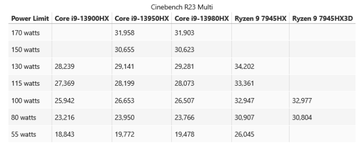

That’s the problem at what cTDP?
75watts, 100watts?
Then at wall power that same cpu uses around ~160watts in Cinebench.
I m talking of CPU power, the 7945HX is set at 100-115W, at 80W is score 30.9k in CB R23 and at 115W 33.6k, so not even 10% better despite 44% more power, it s easy to have good efficiency by sligthly dialing down the perfs.

I didnt compare wall power to CPU power, you didnt read right, i estimated the CPU power, for the M4 Max, i stated 70W CPU power while wall power is supposedly 95W on average and idle wall power about 6W.
Same for the M3 Ultra, wall idle is about 9W and wall load power is 270W, so about 200W CPU power, all this was explicitely stated in my previous posts.

Abwx
Apr 2, 2011
12,038
5,014
Fair enough but NBC Cinebench results for the CPU M4 Max power figures you stated are derived from the wall regardless.
You should do the same for the AMD laptop you are comparing with.
They are derived from the wall of course, there s a 95W average delta between idle and load.
An AC adapter has generaly a better efficiency than an ATX PSU, easily 90%, and then there s the integrated SMPS in the MB to feed the CPU that has typicaly 90% efficency for reasonable powers.
That make 0.9 x 0.9 = 0.81% efficency, and assuming that the CPU use almost zero watt at idle that make 95 X 0.81 = 76.95W CPU power, so my 70W was quite forgiving for Apple compared to a more accurate estimation.
For the the AMD 7945HX laptop NBC did set different CPU powers, either in the bios or using AMD s software, to compare efficiency at different power levels, so they made the work for us, from those numbers optimal efficency is at 80W in respect of the process power/frequency scaling.

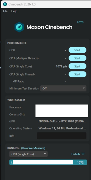

AMDK11
Jul 15, 2019
496
441
M4 Max*
That single core score would be converted to roughly 780-790 single-thread. What magic is that?
Zen 6 this early would be an eng sample at best, stretches to be incredulity.
Zen5(R5 9600X) + DDR5 2x16GB 5600MT
~5.4GHz
ST 525p
SC(SMT) 719p
SC(SMT) 1072p(+49%!!!)
Reactions: lightmanek

jdubs03
Oct 1, 2013
1,510
1,097
~5.4GHz
ST 525p
SC(SMT) 719p
Not sure that’s a good comparison.
The best would be a 9950X3D which I’ve seen go as high as 810 in SC(SMT), and I’m pretty sure that wasn’t stock. So 1072 would be a 32% increase from that.
From the looks of it SMT is doing a lot of the heavy lifting because the ST score only increases by 15-16% compared to the 7950X(3D), so I take it’s SMT efficiency must be a lot better in Zen 5 compared to Zen 4. But could it see such an improvement again with a Zen 6?
But I guess I’ll amend my statement when looking at some of the 7950X(3D) results versus the 9950X(3D), and there is about a 30% or so increase in SC(SMT). So I guess it maybe* could be a top-end Zen 6, but still seems like it would be an engineering sample since we’re about nine months away from products in all likelihood.

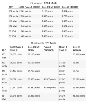

This is another good comparison:
That 9955HX really stretches It’s legs after 100W in CB R23. But not in 2024.
One thing to note as well is that the M-Series isn’t native in CB R23, so score comparisons with that aren’t apples-to-apples.
