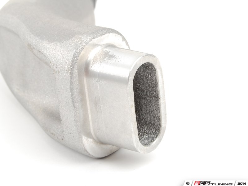

I heard about the crushed walnuts, but how they get them into where the valves are ? Through the air intake or some other way ? And as to how often to clean them, a lot would depend on how bad they are. But I would probably suggest every 25K miles or so (like maybe every 2 years, depending on how much mileage is put on) and a lot depends on gas and oil quality.

At least on my car, you remove the intake manifold and there is a specially formed tool that fits each port opening. It has a vacuum attachment end (for shop vac) and a small hole near the port opening that you can place a blasting 'wand' through. You turn on the vacuum and then turn on the media blaster and rotate it around. As the carbon is removed, it and the media are sucked up via the shop vac.
As for gas and oil quality, maybe oil quality (how much evaporates and gets sucked out via pcv) but not sure gas quality has much to do with it (unless it effects how much blow by gets into the crankcase to be sucked out and pulled over intake valves).
fits right into....
