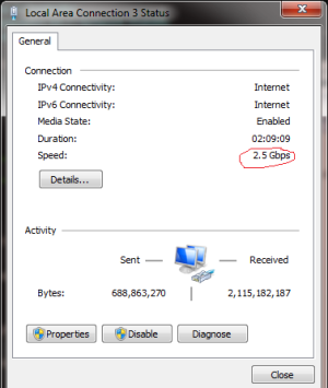

Pics show 2.5gbps is confirmed, if these help at all.

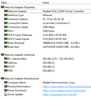

(Left Image) From Everest program

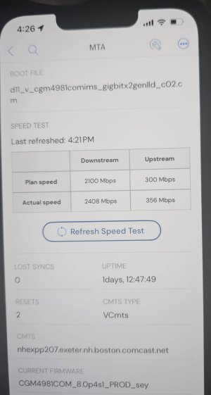

(Center Image) Pic of Comcast tech's phone, showing modem is getting more than 2,100mbit (2,408mbit)
(Right Image) Network Card properties showing 2.5gbps

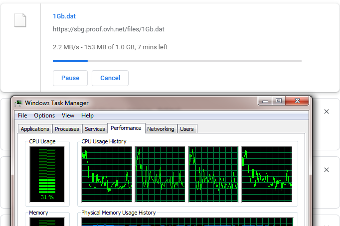

Here is image supporting the notion that my cpu is unaffected by downloading large files at max speed:

I don't have an answer but I do know that with nothing else going on to take CPU cycles, there's no way your Phenom should be at 31% load to merely download files. What else does task manager show is using CPU cycles?

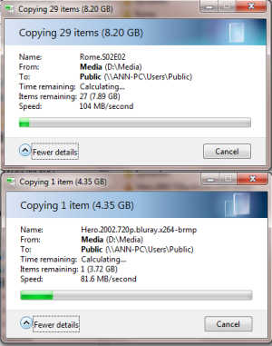

I dont have any network device over 1gigabit to try wired xfer on, but do remember getting 85 megabytes(MB)/sec or so once when testing speeds from this pc to a laptop.
[[Edit: I have a laptop in car that has ethernet port on it and is a few years newer than this pc. Ill try in morning. My much newest Win 11 laptop has no Ethernet port; would have to buy usb one or something. Rather avoid that, unless recommended.]]
Not at all. That system is >5X faster than needed to achieve more than 600Mb. Pretty much anything new enough to have PCIe (and GbE) should be higher, "IF" it is the only load on the system.
I have a similar box on my lan which ironically enough, also runs win7, and it saturates GbE on the lan (granted SSD's are the key there) , including through the router's built in switch.

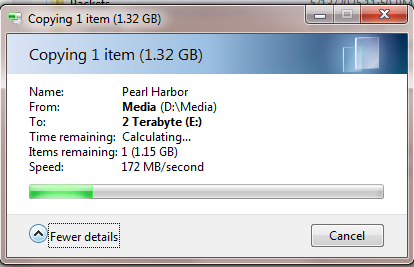

I get this speed (100MB/s min, 200 max) from the 2 better HDDs and the SSD to one another, though this is over sata within pc; hdd to hdd/ssd not over lan.

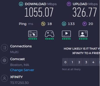

I'm testing dl speeds via 1 of 3 dif sites; ookla, comcast, and google fiber. Tried others too; all say same.

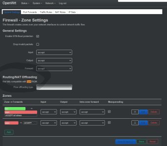

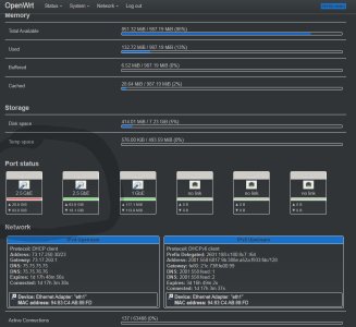

I could not find QoS in OpenWRT (im navigating it via LUCI gui of OpenWRT, as OpenWRT is new to me,Im used to DD-WRT.
This is only reference to QOS I found:qos.jpg
Here is a snapshot of the ports. This also shows 2.5, while before those 2x2.5 port showed g when they were hooked up to my old 1g onboard eth mobo port.

And yea, definitely a bottleneck. Since last night, its actually dropped back to 600-700mbps. Go figure.
