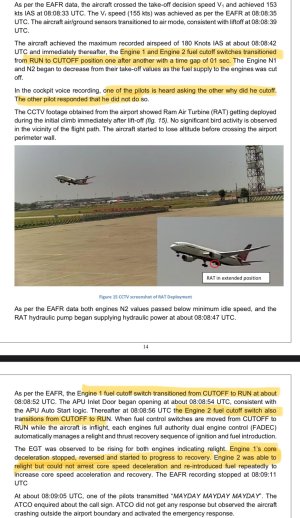

Preliminary report released.
The Engine 1 and Engine 2 fuel cutoff switches transitioned from RUN to CUTOFF position one after another with a time gap of 01 sec.
In the cockpit voice recording, one of the pilots is heard asking the other why did he cutoff.
The other pilot responded that he did not do so.
Either someone made a massive error or this was a murder/suicide.

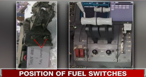

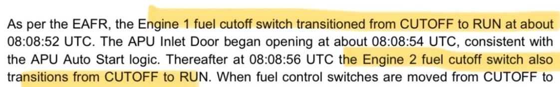

So tragic, it’s somehow more terrifying than I could have imagined. I’m highlighting the most relevant parts of the report below:
After the fuel cutoff was recognized someone did initiate the procedure to restart the engines but obviously they had way too little altitude.
This is what the controls in question look like:
Reactions: dainthomas

Sadly, we will probably never know the full story. All we have is the black box data:
According to the report, the flight lasted around 30 seconds between takeoff and crash. It said that once the aircraft achieved its top recorded speed, “the Engine 1 and Engine 2 fuel cutoff switches transitioned from RUN to CUTOFF position one after another” within a second. The report did not say how the switches could have flipped to the cutoff position during the flight
The switches were flipped back into the run position, the report said, but the plane could not gain power quickly enough to stop its descent after the aircraft had begun to lose altitude.
Along with the cockpit recording:
The report also indicated confusion in the cockpit moments before the crash.
In the flight’s final moment, one pilot was heard on the cockpit voice recorder asking the other why he cut off the fuel. “The other pilot responded that he did not do so,” the report said.

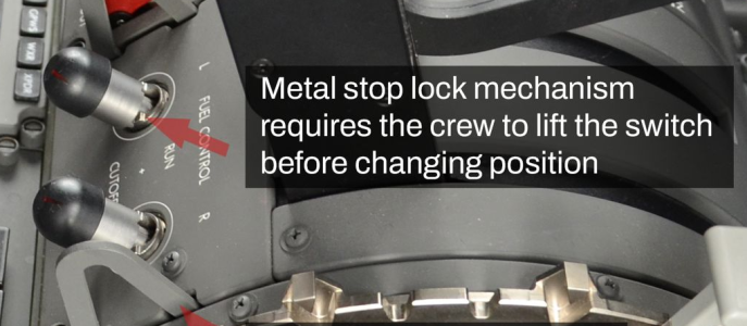

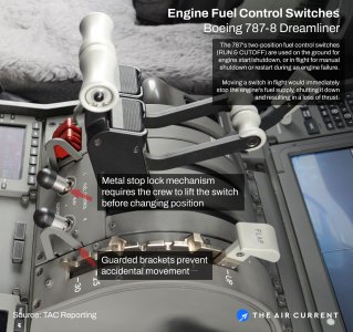

From the picture in @yottabit post, there are two separate switches that both require special access to operate:
There was a 4-second delay between switch operations. In physical practice, that would be a two-part manually-operated movement:
1. Lift & switch #1
2. Lift & switch #2 a few seconds later

According to the AAIB report, both fuel control switches governing engines 1 and 2 were turned from "RUN" to "CUTOFF" within one second of each other. The switches, located on the central pedestal of the cockpit, are protected by a guard rail and require deliberate effort to toggle. They are not touch-sensitive and cannot be triggered by turbulence, power failure, or software glitch.
There was no time to recover:
“Unfortunately, the altitude was so low that the engines were only beginning to recover and they didn’t have enough time,” Tozer told Sky News.
Two actions to trigger - lift and move the switch and someone correct me but if it had only happened on a single engine they would have likely been ok so two failures (both switches thrown) before realization of the catastrophic hazard.
Doesn’t seem like a Boeing problem unless there was something in the circuitry that affected both switch positions at the same time.
