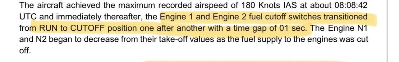

Two actions to trigger - lift and move the switch and someone correct me but if it had only happened on a single engine they would have likely been ok so two failures (both switches thrown) before realization of the catastrophic hazard.
Doesn’t seem like a Boeing problem unless there was something in the circuitry that affected both switch positions at the same time.
The report states both switches were thrown 1 second apart, so it even all but rules out any kind of simultaneous failure. I really don’t want to speculate but unfortunately I feel like premeditated nefarious action is the most likely explanation.
I don’t know of any similar actions that would be performed to throwing those switches. But in any case, this is something you don’t mix up - it would be like switching off your car ignition right after you pull onto the highway.
I’m sure there were all kinds of alarms going off after the fuel was cutoff, which is what led to the other pilot asking why it was cut. Within 10 seconds of fuel cutoff they switched fuel back on and initiated the engine restart procedure but there just wasn’t enough time.

Right but my point was the two cutoff switches were actuated one second apart (about how fast they could both be intentionally switched by one motivated pilot)
It’s this time gap of one second that IMO precludes a common cause failure. IMG_1400.jpeg
It’s this time gap of one second that IMO precludes a common cause failure. View attachment 127043
Other indicators this is probably due to human factors are the lack of the grounding of any other 787 by Boeing or regulators, and Air India reportedly taking actions around their pilot training program shortly after the incident

I thought of that. Well, the system is only as good as its design and implementation, however that plane crash resulted in the death of some ~280 people. Clearly the system in place failed to prevent that.
Safety starts and ends with us humans. There is no system, or safety mitigation that can be developed that won't fail, at some point, or can't be manipulated. All safety measures and protocals are only secondary procations to aid us humans in staying safe. The problem is, we humans tend to start relying on such safety mitigations and become complacent relying on sensors, safety procations, etc, which in itself is dangerous, because that shit fails all the time. Yet, people believe that the safety measures will prevent them from doing something stupid, so they just blindly act because they have put all their faith in mechanical/electronic/software that they believe will prevent them from being stupid. A simple example is cars now days, that tell you that someone is in the other lane (some won't even allow you to manuever to the next lane), to the point that drivers don't even check their mirrors and/or look over their shoulder before changing lanes.. resulting in accidents because they have become reliant on the built in safety protocals and become lazy and complacent. Hell, every person on this board should know that software, electronics, etc fuck up and fail all the time. Yet your solution is to have AI, which is nothing more than software and electronis, to "protect" us from people's own stupiditly, and/or mental instabilities. No matter how much we try, we will never be able to remove the human factor, AI is just an extention of that, just in a different form.

So, it's better to have unhinged pilots crashing planes than software that's designed and tested to be fail safe, but could conceivably fail?
I personally wrote a lot of code for a mission critical application for the company of my employ over 2+ years. I alone wrote the code changes, surveyed and tested each release and there were many. IIRC, I never had an embarrassing or serious failure that I couldn't remedy easily and quickly. In fact, I don't remember failures at all. You don't release code that can fail, was my mantra. You test it to your satisfaction. When hundreds of lives and many millions of dollars and a major corporation's reputation are at stake, you are that much more careful and testing methodologies take center stage.
No software of any complexity is “failsafe”.

It’s kind of silly to suggest software level safeguards for this. The fundamental question is “do we want pilots to be able to fly the plane?” and if the answer is yes, which it is today, they’ll always have the capacity to crash it. Almost every system on a plane has some manual override or backup.
But the human factors side is mostly solveable. If it was due to fatigue then well that’s corporate greed stretching the scheduling and staffing requirements too thin.
And if it was due to mental health issues then they need to figure out some way to change the stigma around that for pilots. Like maybe promise employer sponsored paid leave until they can be cleared for duty again.
Currently pilots are highly disincentivized from sharing their mental health status and there’s been fatal crashes because of it
Neither of these things are likely to change without government intervention and forced regulations
