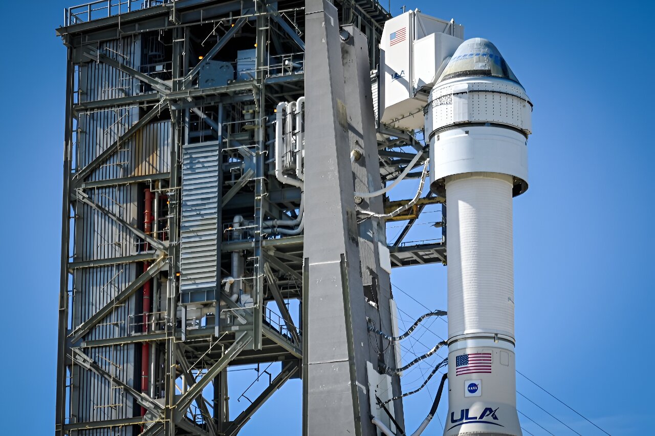

You have no idea how many meetings we’ve had.
I can imagine.
'we have a leak, we need to fix it'
'that'll take weeks, what are we leaking?'
'helium'
'that's not explosive, just launch with it leaking'
'it's still a leak, that's still not good... if we can't guarantee the integrity of <doodad holding helium> how can we guarantee the integrity of <doodad holding hydrogen>?'
'because we haven't noticed any hydrogen leaks, launch it!'
