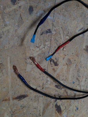

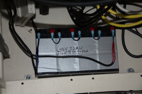

Made battery cables and battery pack is wired in. Running a 240w test for a few days to make sure everything is good and safe, then I'll transfer my workstations to it. I'll keep them on UPS for a bit more run time, since this battery pack is not really going to give all that much run time on it's own. As-is this setup is not really accomplishing much other than providing clean inverter power, until I put in the big batteries.
Didn't do proper cable management as this is still fairly temporary.
70,763
13,863
Not bad, got a half hour out of those batteries with 250w load. Charging back up now. Nothing is getting warm anywhere so think my wiring is good and I'm ready to let this go for a longer term test.

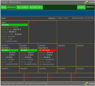

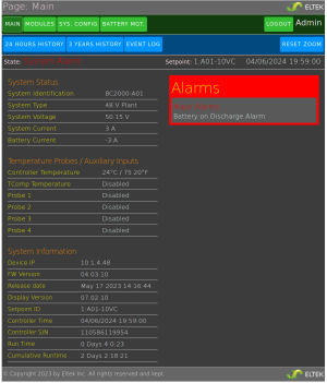

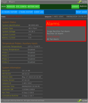

Doing a discharge test again, it should run for more than half an hour this time since the workstation that's on uses 150w and the other is off.
Rectifier 1 is unplugged but inserted so it generates an alarm. Pulled it out, I'll only run on 2 for now.

Dropped pretty much right after I posted that then UPS picked up. 55 minutes, not bad though for only 4 small 7.2ah batteries.
