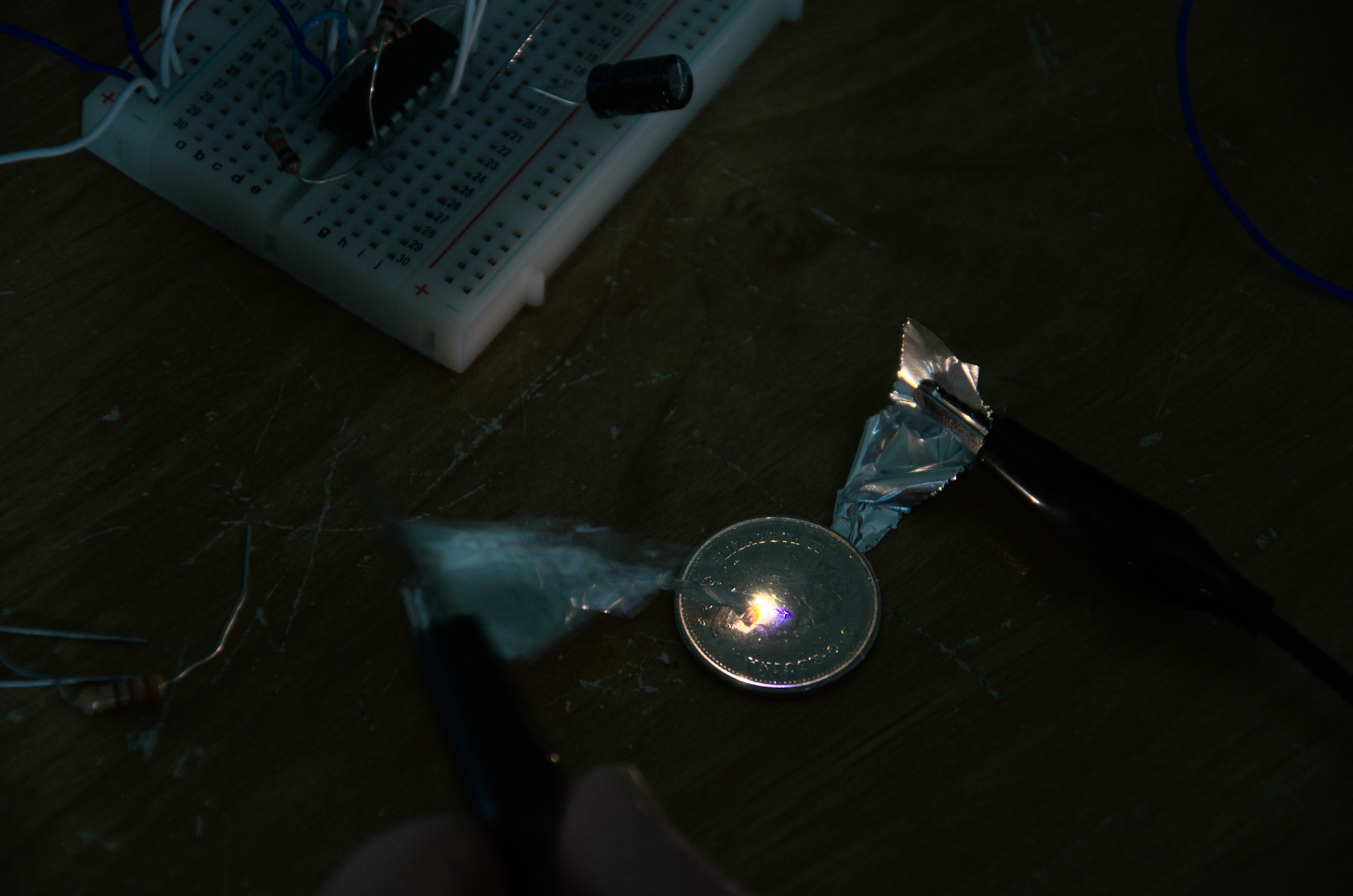

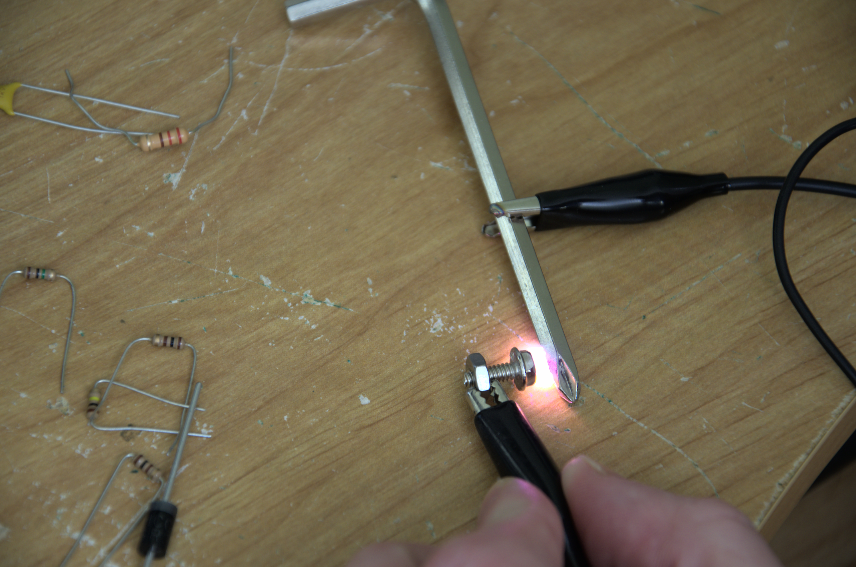

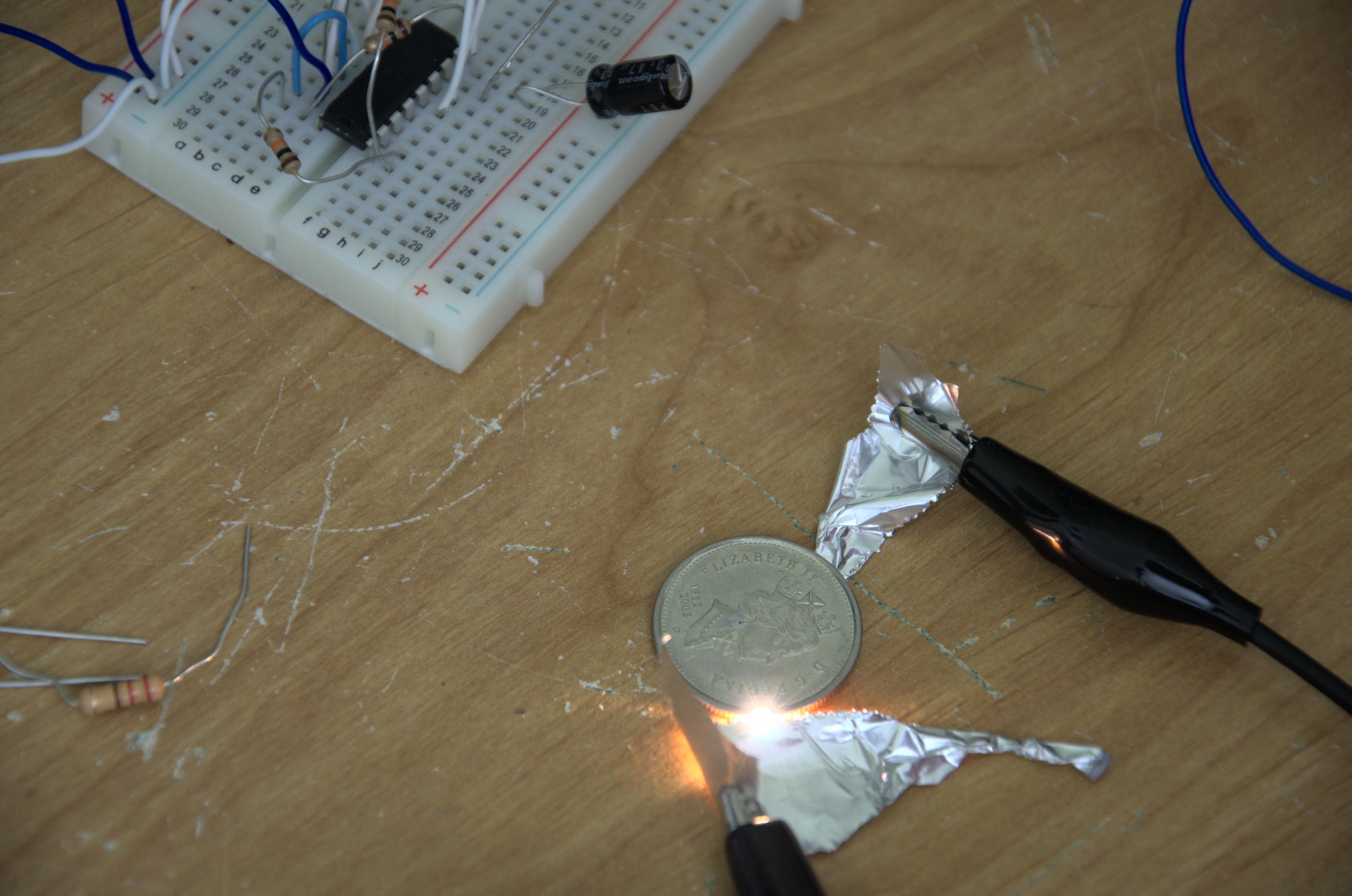

As a side note finally got around to playing with a push-pull controller chip I bought a while back. Was tricky to get it going, datasheet did not really have that great of an example circuit. Was going to use just one side to do a make shift flyback but I'm not getting enough chooch, I think I will wind a new centre tapped transformer and do a proper push pull config like this chip is made for. Technically I'm only getting 50% duty cycle the way I'm trying now.

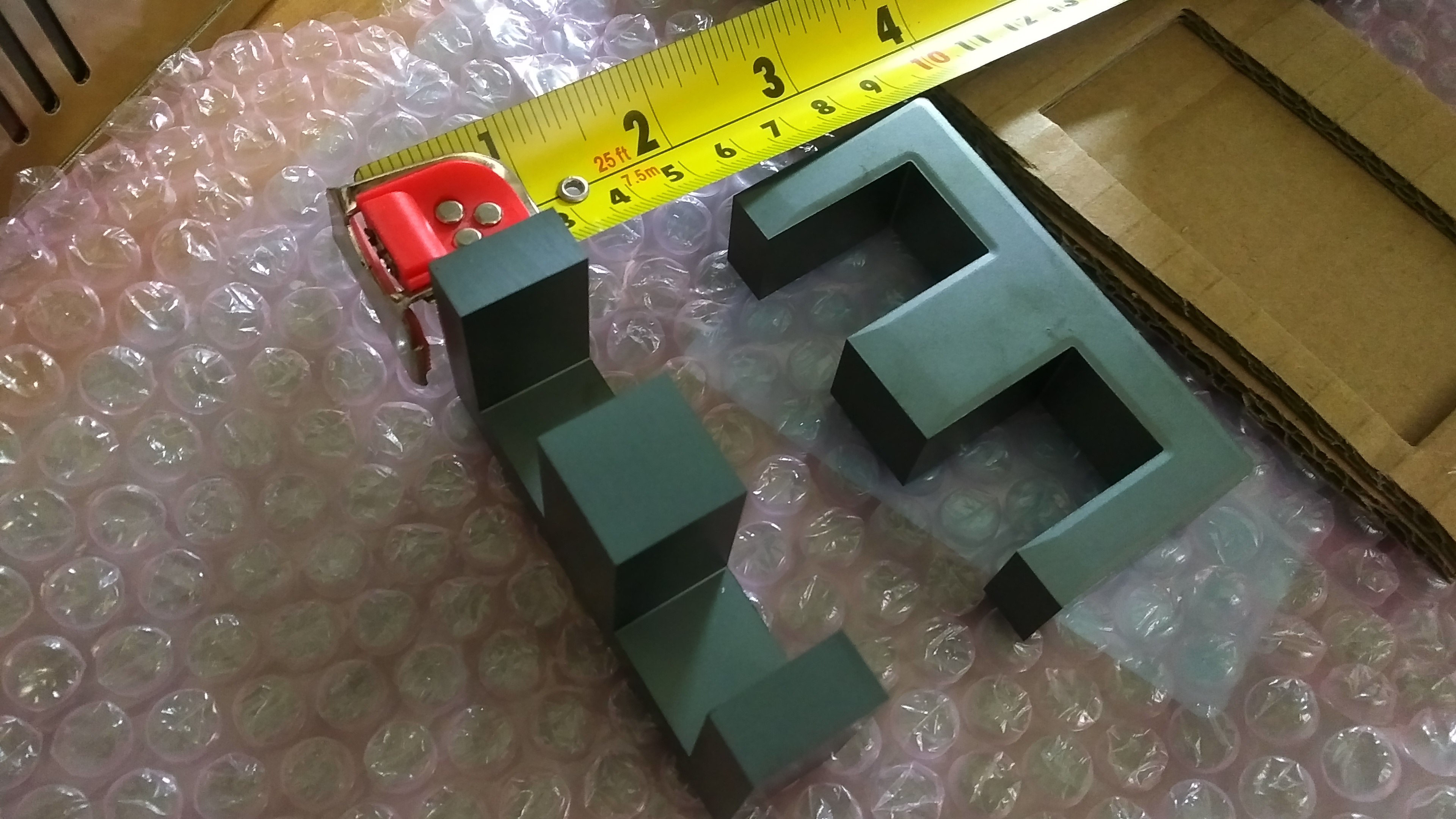

Might need to use a bigger core too. Bought this bad boy a while back though I had another project in mind for it.
Ridiculously overkill though. I think if I use the smaller cores I got on hand and just do a better ratio and use push pull I should get decent power out of it. The current one I'm using is optimized for 5v in with only 1 primary turn and I'm using 12v but I think it's saturating and most of the current just dies in the winding as a short basically. Fet was getting hot even with no load on other side.
A while back when messing with it I had a nice arcing going on with the one I'm trying but in the wrong place... lol. rewound it since then and because of the isolation layers I don't have as many turns.
So yeah might move to that beefy one. Try not to electrocute myself with that thing.

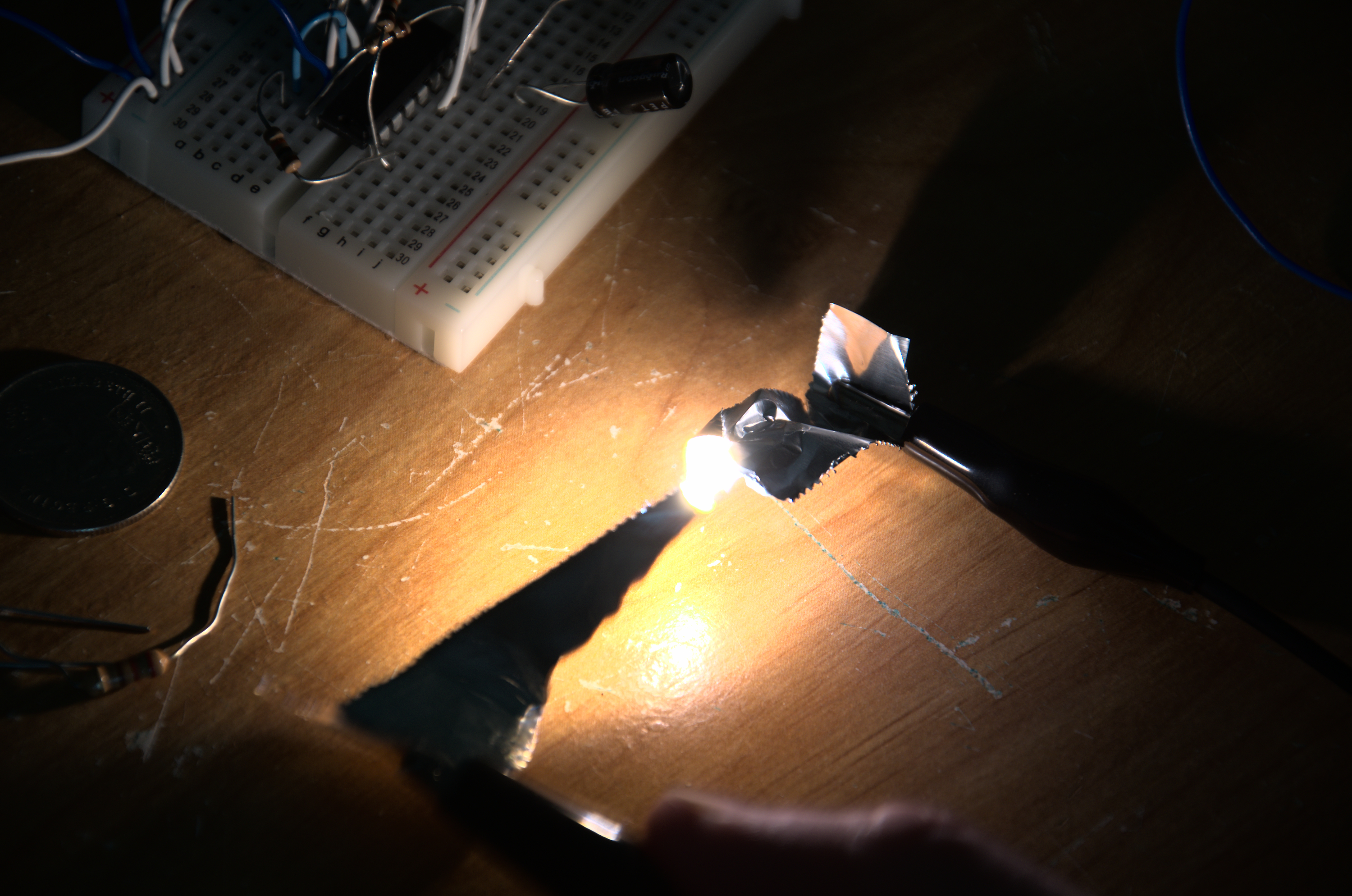

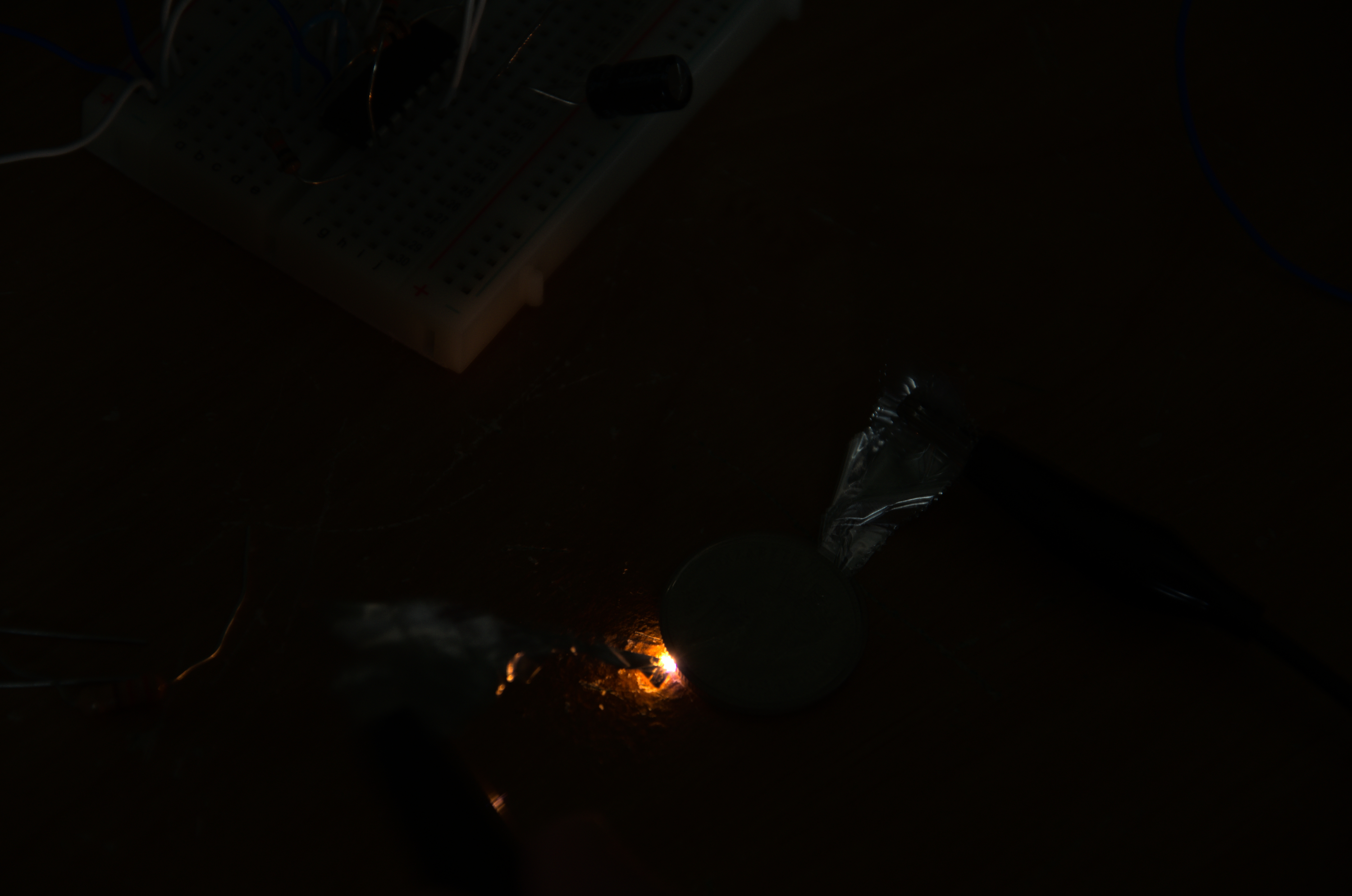

Ok I'm done for tonight. But yeah this is still not quite enough to create an ozone generator. But wow I can smell the ozone almost instantly when I do draw an arc though. Might play around with a voltage multiplier circuit before the transformer.
