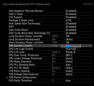

The Current Limit is now 512A.
someone who translated that bios from chinese to english must of gotten that wrong.
The A must mean GB.... and was intended to for GPU memory allocation, not current. :O
I dont see any other case where we would use a 512, as its divisible by 4, and typically used on RAM until reciently with the inception of 24GB stick.
Oh wait thats even divisible by 4.
They shouldn't be removed for you at the first sign of customization, especially considering they are in a different screen within the UEFI.
