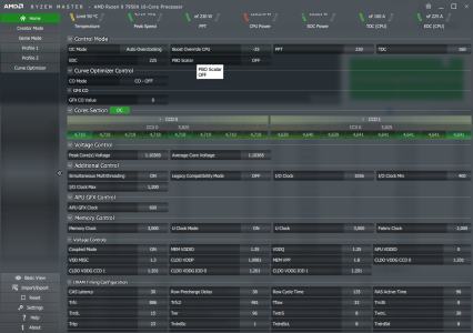

Where is vsoc here ?? I see a VDDCR SOC at 1.25 Is that it ?

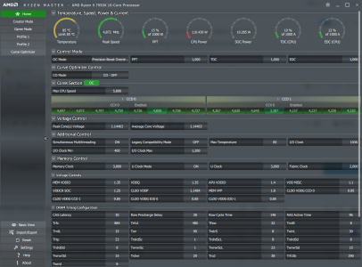

It's VDDCR_SOC.
Which on at least the handful of ASRock boards tested by GN and Level1Techs sets it to 1.2-1.25V with EXPO, and closer to 1.0V with Auto settings. Unlike ASUS which defaults to overly high SOC voltage.
The one you quoted is an ASUS board, and I see 1.25. The second pic is ASRock and I see nothing that SOC anywhere in the voltage description. Its a Taichi.

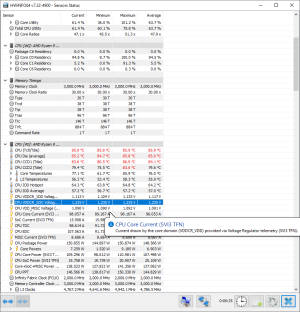

You're seeing what is set in the BIOS, not the actual readout on the voltage.
Try hwinfo64 and look for the CPU SOC voltage and see if it matches. I suspect it overshoots the actual setting like it does on all my ASUS boards.
Do I see 1.235 ? Thats ASUS BIOS 1410.

HWINFO on mt Taichi also say 1.235. And I got that motherboard when the Zen 4 first came out, and the bios is original. ALL of my 7950x's are working just fine. I have 5 of them.
So, looks like for your board/memory combo on that BIOS it sets VDDCR_SOC to 1.25V and on load the vdroop causes it to go to 1.235V. Both of which should be safe. Assuming the software reading is accurate and ASUS isn't using some VRM trickery.
Aside from older ASUS BIOS, I don't see this as an issue , aside from some want to make it seem spectacular and a fail.
