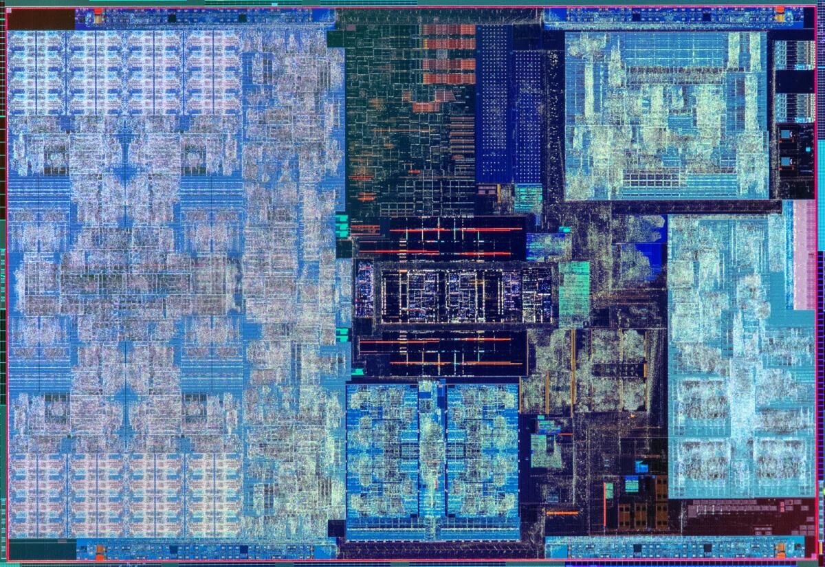

Antey
Jul 4, 2019
105
153
Sunny cove core 10nm INTEL: 4,46 mm²
Tremont core 10nm INTEL: 0,84 mm²
Sunny cove (icelake) 10nm INTEL: 6,91 mm² (wikichip).
Lakefield sunny cove is way smaller than it's icelake counterpart, or i wrongly read the total area or it is indeed smaller.
Edit:
Knowing that Lakefield was going to have to take the lowest common denominator from the two core designs, Intel physically removed the very bulky AVX-512 unit from the Sunny Cove core.
wow, it seems AVX takes a lot of space!
Image: die área is 82mm² (compute die). 1200px*825px or 10,92*7,511 mm
DrMrLordX
Apr 27, 2000
22,744
12,747
They actually produced a cut-down Sunny Cove core for Lakefield instead of just doing a direct optical copy? Interesting. Wonder how much that cost them.
IntelUser2000
Oct 14, 2003
8,686
3,787
Edit:
No, and No.
You can see from the die shot its the exact same core as the one in Icelake. And you can see the AVX units.
Icelake's version is only larger because it includes the L3 cache and the FiVR.
