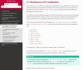

Next step for me is finding out how to upgrade from debian 13 to 14 over the next 2 years so when the time comes I can do it without a clean install and not formatting /home drive.
Must be a guide somewhere.
Best to read the release notes. There's a specific page for every release. Here's the ones for upgrading to trixie...
They're very thorough, and use a lot more care than I do. I make sure all important data is backed up, fully update the existing install, update the sources list, then upgrade.
For example. I'm running bookworm...
Code:
apt update && apt upgrade
Now bookworm is fully updated, so I change my sources list to either trixie or stable. Using the release name locks you into that. You won't ever get anything else. Using the generic term "stable" tracks the stable branch, and you can get new packages beyond trixie after it's been released, but not before.
Code:
Code:
apt full-upgrade

It's easy. Just open up the list as administrator and change every instance of "bookworm" to "trixie". It can be done with find/replace. I'd probably recommend using the release name instead of the branch, eg "stable". That way there's no surprises. You get upgraded when you're sure you want to upgrade. Just have to change the source list every couple years.

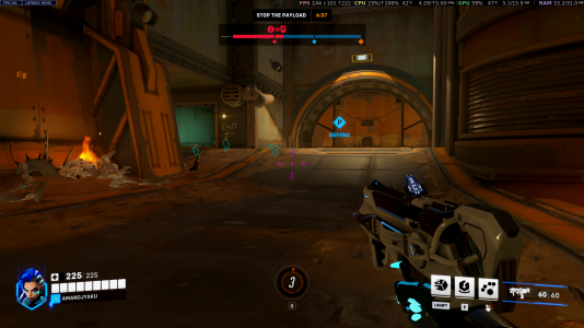

Yep ok.. 30 +1 days in debian and still getting 144 fps..
Problem was definitely fedora and other distros.. not linux.
Debian is working out great!
