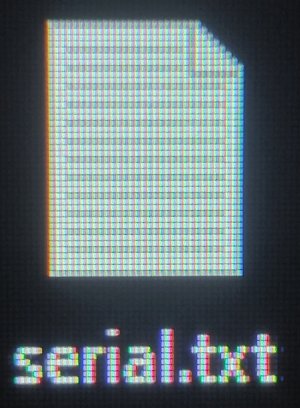

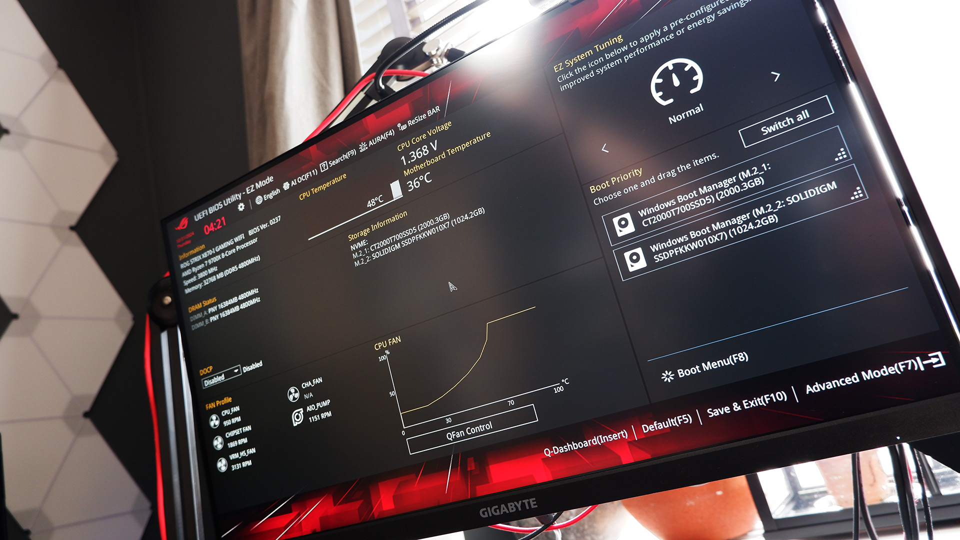

Yes, I understand that the resolution of the internal bios is 1024x768, just imagine that it is 1024x768 and it feels like 640x480. I mean that this problem applies to bios too. So that you can better understand the difference, I asked my friend, who has no problems with his PC, to take a photo of his desktop with the same matrix model.

When looking at the images, i see no issue. The text is readable. What you describe sounds like what can be an issue is the clock signal, i remember about clock phase. Maybe you can try to change that in the monitor settings of the monitor On Screen menu .

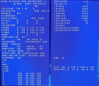

im use xl2566k, that is service menu settings. Inside regular i dont find "clock" any.
Can't you see that my font is blurry and harder to read?
The problem is not just pixelation. The problem is that 360hz / 360 fps does not feel like 360. In the motion of the picture, I see jitter. My mouse and keyboard are slow to respond. The picture is not what it should be. I'm not the only one who experiences this. You can just google pixelation/blurry/grainy and you'll see tens of thousands of threads where the problem has never been resolved. The only solution at the moment is a completely new mobo/cpu, and genuine windows.
