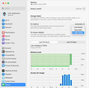

Windows has different performance profiles for battery vs. plugged. If you really want more performance on battery, it can be done with a button switch and it will stay that way indefinitely. You could argue the Apple way is better user experience by using a different default option, I can certainly argue Microsoft has made a mess by keeping both "power plans" and "power modes" while allowing OEMs to introduce their own power management on top.
All that being said though, full CPU performance on battery is not necessarily the superior alternative you keep pushing for it to be. People have different usage scenarios for their machines, and even different user scenarios when plugged vs. unplugged. If I got a Mac today, I would certainly look into maximizing performance while plugged in and optimizing performance while on battery. I'm also aware other people may prefer it differently.
