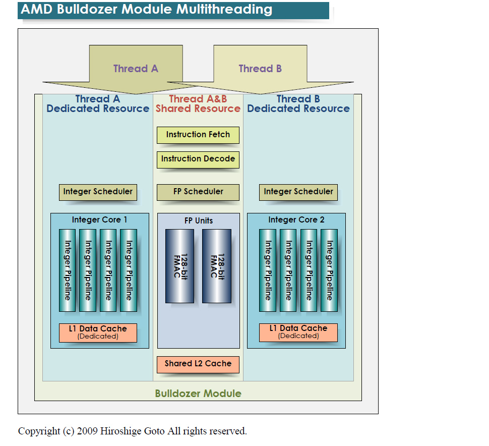

• Two integer clusters share fetch and decode logic but have their own dedicated Instruction and Data cache
• Integer clusters can not be shared between threads: integer cores act like a Chip Multi Processing (CMP) CPU.
• The extra integer core (schedulers, D-cache and pipelines) adds only 5% die space
• L1-caches are similar to Barcelona/Shanghai (64 KB 2-way? Not confirmed)
• Up to 4 modules share a L3-cache and Northbridge
• Two times 4 Bulldozer modules (2 x 8 "cores" or 16 cores) are about 60 to 80% faster than the twelve core Opteron 6100 CPU in SPECInt_rate.

gaia I think if you scrutinize the info in the quotes you gave a little more closely you'll see they are all conflating modules with cores and equating the doubling of resources within a module as being equivalent of beefing up each core, and then multiplying (incorrectly) the module's execution capabilities by the publicized core count.
In other words it would appear all the quotes you quoted double counting the processing capabilities of a Bulldozer "core" and then erroneously comparing them to a nehalem core (or istanbul core as we are attempting to do).
