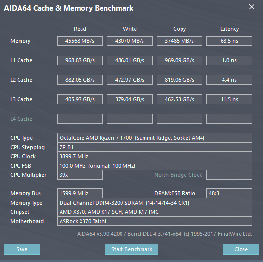

running the 1700 at 3.8 ghz with the RAM at 2667 and I have yet to have any additional issues, with booting or shutting down.
i disabled the boost and c6 state CPU features, along with adjusting additional voltages. this is what typically happens, though, i think that I'm learning the platform and then BAM... total failure whilst doing something important. hopefully i can sort it out by the time the new RX cards hit the market.
unseenmorbidity
Nov 27, 2016
1,395
967
That is the best mem latency i have seen at those clocks and timings for Ryzen, have you tried even tighter timings?
I have not. I got it on the first attempt. I looked up the FlareX timings, loaded the XMP profile, and plugged those FlareX timings in and it worked. It's ran aida64 stability test for an hour and 15 minutes without issue, and then I went to grill some burgers.
I am not particularly savvy when it comes to memory OC'ing, so I was happy that somehow worked out.
According to HWmonitor, the VDDCR_soc is at 1.104, which seems kind of high, but still below the 1.2v recommendation I have heard. The DDR voltage was increased to 1.368v, which is also a tad high. Maybe this was loaded with the XMP?
If you had some suggestions, then I could certainly try it. To me, it just feels like picking numbers at random.

I have not. I got it on the first attempt. I looked up the FlareX timings, loaded the XMP profile, and plugged those FlareX timings in and it worked. It's been running aida64 stability test for an hour and 15 minutes without issue. Then I went to make dinner.
If you are pleased with it, wouldn't want to push you to experiment.
The mem latency score was very strong and was curious if you can do better.Maybe the secondary timings are tighter with this BIOS.

Here are my results:
The read is almost identical to yours, but the latency and L1 cache are a little lower.. But I am still on my $89 mobo, my Taichi like you used is still on the way (maybe Tuesday)
