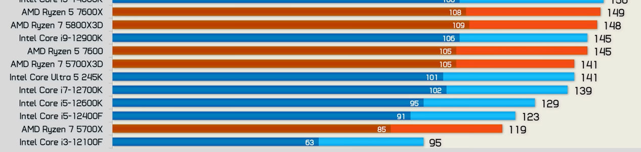

I don't even know, with those core clocks it "might" beat 12600K, but probably not.
It's a limited release SKU. It'll primarily be a drop in upgrade I'd think.

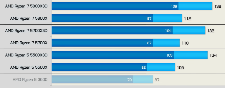

But it will not have any trouble providing a similar experience to a 12600K with DDR5. 3D does not drop off much with lower clockspeed in most games. Has the advantage of not needing overclocking or losing notable performance with dirt cheap DDR4 3600MHz.
Given that there is such a small drop off from the 400MHz clockspeed difference with the 8 cores, that should carry over to the 6 cores. In which case it is going to again, be a similar experience on both CPUs. Here's a 14 game average from HUB from 2/2025 The 12600K is paired with DDR5 7200.
