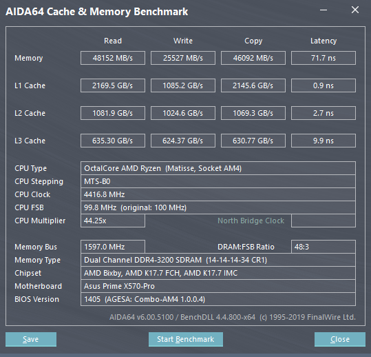

Your numbers look good.
Here are mine at stock XMP settings.
And then with Ryzen Dram Calc fast profile
Will have to see what I get at 3600 speeds.
